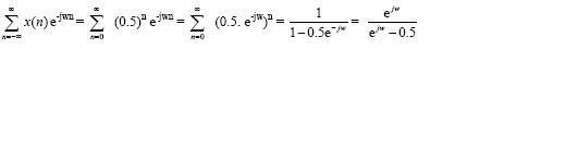

I am trying to compute the DTFT of x[n]=n(.5)^n u[n].
This is my work so far.
Is this correct?

I have solved ths with an answer of
0.5 e^(-jw)/((1-0.5e^(-jw))^2)
