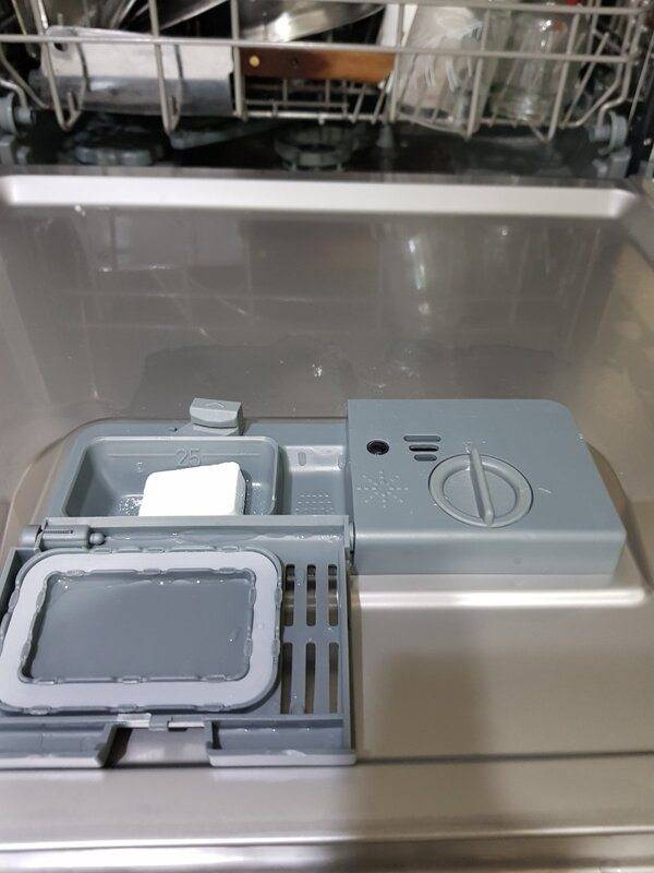

I put a knife at bottom of the dish washer, and this was the result after 2 hour cleaning and drying time (just rarely though). What is the white powder?
Is it the salt? The soap? scales from hard water? Or dried rinse aid?

From past experience (which PF says has no validity) and manufacturers manuals, that is soap build-up, a common occurence.
The fix is to run a cycle or two with a cup full of vinegar in the bottom rack.

Probably soap. What does it taste like?
It seems the white buildup was inside a circle made by contact with the lip of a cup. It might be that the area was not washed because the cup sheltered the knife from the water spray. Soap powder could have been trapped on the blade.

Anyway. Since I just owned one. When the detergent bar fell to the bottom, how does it get into the upper spray fan? Is there pump of some kind for water at bottom to recycle above?

If the fan got stuck by a utensil, would the fan blades break or is the fan run by some kind of water pressure? what's the mechanical impeller at center?
It's like a lawn sprinkler (but slow).
There is a pump at the bottom.
