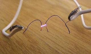

I suspect this limit represents the strength of the dielectric. If so, then how can the resistor's rated power ever be attained/achieved? Of what use is that figure then?
A resistors power rating in Watts = Volts x Amps. There is a point where increasing Volts can cause this:
http://en.wikipedia.org/wiki/Electrical_arc
Thanks for the reply, Don. I guess I should re-phrase my question by asking: Assuming the datasheet resistance value stays roughly constant, then of what importance is the wattage rating if one cannot even attain that without risk of arcing? Shouldn't the datasheet wattage be taken from V^2/R (since this other quantity is clearly less than the datasheet wattage)?

We SHOULD interpret the wattage rating as continuous. Think about this: On a sine wave, the RMS volts is .707 * peak voltage. Average power is derived from RMS volts * RMS amps. So if you apply an AC voltage (sine wave) to a resistor that almost exceeds it's power rating, it may be possible you ARE exceeding its voltage rating. Not likely, but not impossible. A more likely scenario is what was described in post #6.
Posts 5 & 6 both hit the answer.
Place yourself for a moment in the shoes of manufacturer.
You have a line of resistor bodies in various body sizes, each capable of dissipating Xsize watts (or milliwatts)
Each size offers resistance values ranging from probably one ohm (or 0.1 ohm) to megohms. And by size is how they're sorted in your catalog.
What is the limiting factor for each body size - watts or volts per inch of the internals ? observe dlgoff's arcing, that's a 1000 word picture if ever there was one. But only in high ohm values will you hit the volts-per-inch limit before the watts limit.
It's unusual in garden-variety circuit design to bump against the volts-per-inch limit because most consumer electronics doesn't have high enough voltage.
So it's not emphasized much in our education .
But the prudent designer is aware of it as just another limit to be observed.
