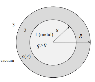

You have a conducting sphere (Region 1) of radius a carrying free charge q > 0 surrounded by a neutral dielectric shell (Region 2) of relative permittivity ε(r) = α/r, r ≥ R, where α is a constant with dimension of length, and vacuum outside (Region 3).
Find Displacement field everywhere.
D = ε_0*ε(r)*E
Where ε_0 is permittivity of free space, and ε(r) is the relative permittivity, and E is the electric field.
I know that inside region 1, the D-field is zero as it is a conducting sphere, the E-field must be zero. It makes sense that in region 2 (inside the dielectric) there is a D-field.
My question is, is there a D-field outside the dielectric material (r>R)? Obviously there will be an E-field, but now there is only the permittivity of free space, ε(r) is 0 correct? So is the D-field zero outside dielectric material or is it continuous?

The equation you quote is good everywhere. What does it tell you? What you say about ##\epsilon (r) ## is incorrect. It is 1
Likes RyanUSF
So with that being said, the D field outside (region 3) essentially becomes the what the electric field would be in that region (multiplied by ε_0 of course). D (r>R) = q/(4*pi*r^2), units of C/m^2 look good.
Also do you understand the continuity question? There are bound (polarization) charges and free charges, and you need to understand which is important for D and for E so tell me about it.

Is the E field contiuous across the inner (r=a) surface)? By how much does it change?
hutchphd said:
True but not complete.
For r<a the electric field must be 0. At r=a there is a surface charge over the sphere giving an E(r=a)=q/4*pi*ε_0*a^2. a<r<R E will change by dividing by ε(r).
