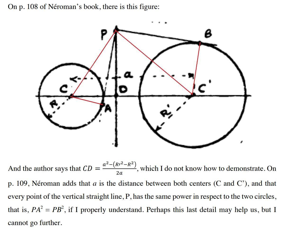

Hello, everybody:
I am a philologist who is fond of mathematics, but who unfortunately has just an elementary high school knowledge of them. I am translating La leçon de Platon, by Dom Néroman (La Bégude de Mazenc, Arma Artis, 2002), which deals with music theory and mathematics in the works of Plato. The problem which brings me here is not about translation, but about mathematics. Please see attachment.
Thank you very much in advance for whatever answer, and best regards.

Reference the attached marked diagram.
Line segments PB and PA are tangent to each circle. As such, they form right angles $PAC$ and $PBC'$
Using Pythagoras ...
$PC^2 = R^2 + PA^2 \implies PA^2 = PC^2 - R^2$
$PC'^2 = R'^2 + PB^2 \implies PB^2 = PC'^2 - R'^2$
$PA^2 = PB^2 \implies PC^2 - R^2 = PC'^2 - R'^2$
from the last equation above ...
$R'^2 - R^2 = PC'^2 - PC^2$
using Pythagoras again ...
$R'^2 - R^2 = (PD^2+C'D^2) - (PD^2+CD^2)$
$R'^2 - R^2 = C'D^2 - CD^2$
factoring the right side ...
$R'^2 - R^2 = (C'D - CD)(C'D+CD)$
note $C'D = a - CD$ and $a = C'D + CD$
substituting ...
$R'^2 - R^2 = (a - 2CD)(a)$
$\dfrac{R'^2-R^2}{a} = a - 2CD$
$2CD = a - \dfrac{R'^2-R^2}{a}$
$2CD = \dfrac{a^2}{a} - \dfrac{R'^2-R^2}{a}$
$2CD = \dfrac{a^2 - (R'^2-R^2)}{a}$
$CD = \dfrac{a^2 - (R'^2-R^2)}{2a}$

Write $d$ for the equal distances $PA$ and $PB$, $h$ for $PD$, and $x$ for $CD$, so that $DC = a-x$.
Since $PC$ is the hypotenuse of both of the right-angled triangles $PAC$ and $PDC$, it follows that $$R^2+d^2 = x^2+h^2.$$ Similarly, it follows from the triangles $PBC'$ and $PDC'$ that $R'^2 + d^2 = (a-x)^2 + h^2.$ Subtract the first of those equations from the second, to get $$R'^2-R^2 = (a-x)^2-x^2 = a^2 -2ax.$$ Therefore $R'^2 - R^2 = a^2-2ax$, so that $x = \dfrac{a^2 - (R'^2 - R^2)}{2a}.$
Notice that $x$ turns out to depend only on $R$, $R'$ and $a$, and is independent of $d$ and $h$. This shows that the locus of $P$ is indeed the vertical line through $D$.
