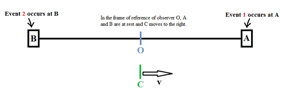

Observer O at the origin of a coordinate system is at rest relative to two equidistant space stations located at x=+3.00×10^6km (station A) and x=−3.00×10^6km (station B) on the x axis. In reference frame O, station A sends out a light pulse at t = 0 (event 1) and station B also sends out a light pulse at t = 0 (event 2). Observer C moves relative to O with velocity 0.650 c0 in the positive x direction.
What is the displacement from event 1 to event 2 according to observer C?

The distance between the two stations A and B according to observer O would be a proper length. That is, if you imagine a rod extending between the two stations, the length of the rod according to O would be the proper length of the rod. The length of this rod according to frame C would be contracted compared to the proper length.
But, the distance between the events 1 and 2 according to frame C is not the same as the length of the rod according to frame C. Can you see why?

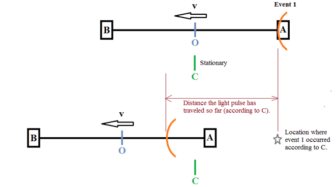

You seem to be saying that as the light travels from event 1 towards observer O, observer C sees O move nearer to where event 1 occurred (according to C). I don't think that's right. Just to make sure we're together on the setup, here's a diagram of the situation from the point of view of observer O. Note that C moves to the right according to O.
So, if you switch to the reference frame of C, in which direction do A, B, and O move relative to C?
If A, B and O are all at rest relative to each other then they all move to the left at the same velocity in C's reference frame.
I was able to solve the problem using Lorenz' equations, but I guess I get a little confused about the difference between an event occurring and an event being received/observed. In C's reference frame O is still equidistant from where event 1 and 2 occur, and O still receives both pulses at the same instant. So if the distance both events travel are equal to each other and are received at the same time by O in both frames of reference, how can observer C conclude at all that the events are not also simultaneous in his reference frame?
According to C, observer O is always equidistant between stations A and B. But C would not say that O remains equidistant between the place where event 1 occurred and the place where event 2 occurred. It might help to look at the picture below.
The top figure shows the situation according to C at the instant event 1 occurs. The bottom picture shows the situation according to C at some later time when the light pulse from event 1 is still traveling toward O. The star in the bottom picture marks where event 1 occurred in C's frame of reference.

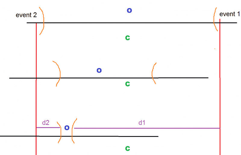

It would be helpful to draw some more figures similar to the one above. Draw a figure for the instant when event 2 occurs. Has event 1 already occurred at this instant according to C? Below this figure, draw another figure for the event where both light pulses arrive at O.
I think I understand now.
First of all it wasn't until I saw your diagram that I realized event 1 was on the positive axis and event 2 was on the negative axis. I had them switched, so when I was arguing that event 2 occurred first in C's frame, I meant event 1.
But to re-approach my argument with what I think is the correct reasoning: events 1 and 2 are stationary in C's frame. The stations themselves and O are all moving away from C at the same velocity. When both pulses reach O, O is closer to event 2 in C's frame. This means, in C's frame, the pulse from event 1 had to travel a greater distance to reach O at the same time as the pulse from event 2, so event 1 must have happened first.
I included a very crude diagram to show this. I hope this is the correct reasoning.
I would agree that when the pulses arrive at O, O is closer to the place where event 2 occurred than where event 1 occurred (according to C).
Yes!
Your diagram seems to show pulse 2 traveling slower than pulse 1. It also shows event 2 occurring at essentially the same time as event 1. But, as you said, event 1 occurs earlier than event 2.

Ah, the mistake in my diagram is that I tried to show events 1 and 2 simultaneously at the top, as they would be in O's frame. But this is in C's frame.
If I start with the bottom scenario in the diagram and work backwards, the pulse from event 2 will be back at the location of event 2 before the pulse from event 1 makes it back to the location of event 1.
Yes. That's right.
