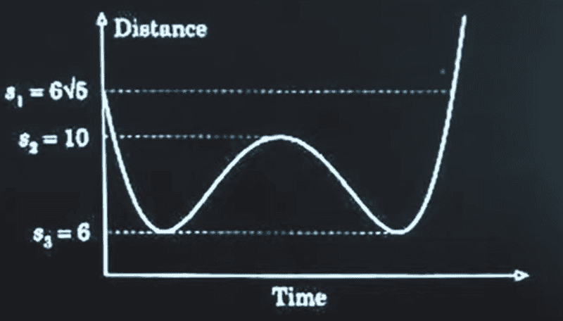

A ball is thrown vertically up. Its distance from a fixed point varies with time according to the given graph (see below). Calculate the ##\text{velocity of projection}## of the ball.

I copy and paste the statement of the problem to the right as it appeared on the website. Given below is the graph of the ball as its distance from a fixed point with time.

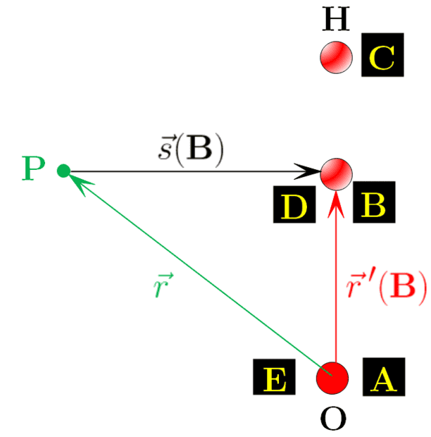

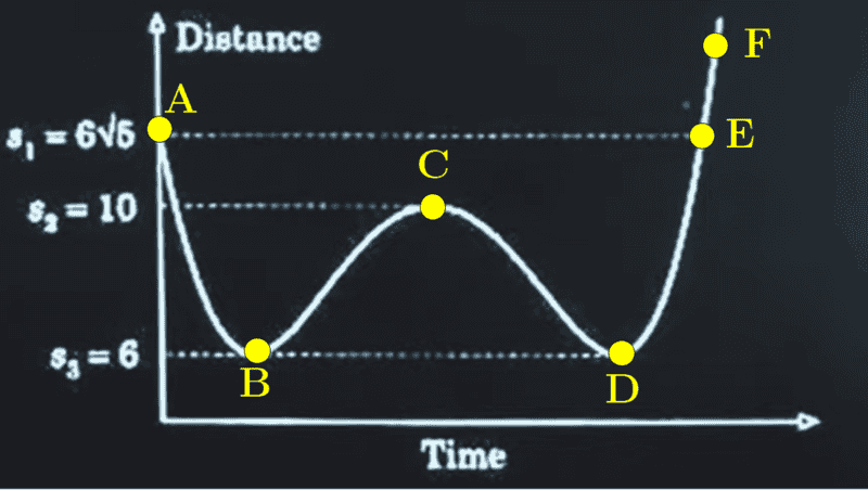

I suspect the fixed point of observation lies outside the path of motion of the ball, as shown in the diagram below. Additionally, for reference, I label points along the graph.
I put points along the motion of the ball that correspond to those in the graph in yellow on black background.
But this diagram cannot be correct.
From the graph, at B, where the distance from P is minimum, the body is at rest (momentarily), meaning its distance of separation isn't changing with time. But from my motion diagram on the right, the distance of separation ##s## is changing with time. So they contradict. Likewise for D.
If you put the observation point P anywhere else, it would violate the distance of separation as given in the graph.
I couldn't do better than this.
A hint or suggestion would be very welcome.
That the change in distance to a fixed point momentarily has zero derivative does not mean that the object is at rest. Consider uniform circular motion for example: the distance to the center is constant but the object undergoing the circular motion is certainly not at rest.
  • Love
Likes MatinSAR, Delta2 and Philip Koeck
For (uniform) circular motion, the velocity vector ##\vec v_0## is everywhere perpendicular to the radius vector ##\vec{r}##. This vector is also the distance of separation ##s##. Because of this perpendicularity, ##\dot s=0## though ##v=v_0\ne 0##. Note the motion doesn't have to be uniform for this to be true, but circular.
For this problem, I should draw things more clearly showing the vector separation ##\vec{s}##.
For the point B, the separation vector ##\vec s## is ##\perp ^{r}## to motion ##\vec r'(\mathbf B##) and therefore ##\dot s(\mathbf B)=0##. At C, the separation vector is clearly not perpendicular to motion. Is ##\dot s(\mathbf C)=0##? Yes. This is because ##\vec s=\vec r'-\vec r##. Since ##\dot r=0## always and ##\dot r'(\mathbf C) = 0##, we have ##\dot s(\mathbf C)=0##. Thus P is a correct point for the motion.

Let us have the graph.

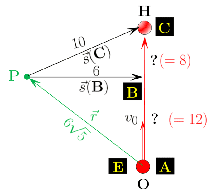

At the point A (time of launch), we have ##\vec s(\mathbf A)=\vec r##. But it's given ##s(\mathbf A)=s_1=6\sqrt 5= r##. At B, ##s(\mathbf B)=s_3=6##. From the right angled triangle in the diagram above on the right, it must mean that at for the point B, ##r'(\mathbf B) = \sqrt{r^2-s^2(\mathbf B)}=\sqrt{36\times 5-36}= 12##. Likewise for the highest point C. I draw the motion diagram below.
For the right angled triangle PBC, ##\mathbf{BC} = \sqrt{10^2-6^2}=8##.
Hence the maximum height attained by the ball ##\mathbf{AC} = 20=H##.
Using ##v_0^2=2gH\Rightarrow v_0=\sqrt{2\times 10\times 20} = \boxed{20}\quad\large{\color{green}\checkmark}##
