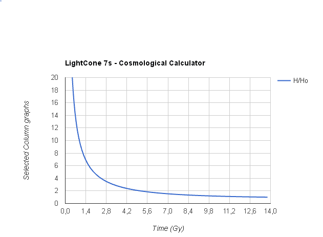

However, the evolution of H is derivable from observables and a given model of the universe, and so is the expansion history of the universe. People certainly do 'worry' about how it's changing. Here's a graph from Jorrie's calculator:
As you can see, the graph is nearly flat for something like last 4 billion years. The deviation from ##H_0## at the 10 Gy is less than 20%.
Chronos said:
The rate of change of the Hubble constant over time is, however, fairly constant.
I don't know. Doesn't look terribly constant.
Likes marcus

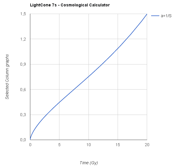

The acceleration/deceleration of the expansion means the evolution of scale factor (i.e. something like average distances between galaxies, where 1 means 'like today'):
Where the switch from downward-sloping (deceleration) to upward-sloping (acceleration) happens somewhere around 7 Gy.

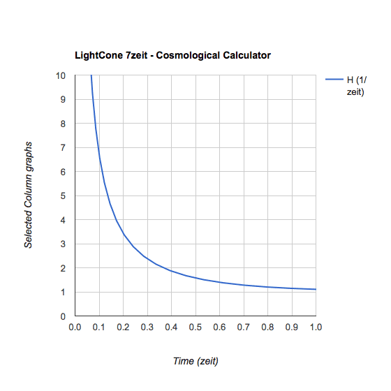

Fortunately, since we have simple formulas for the Hubble constant (and its time-derivative, or slope) over time, we can make this more precise! We can actually plot the history. Bandersnatch already did show a plot of H(t), three posts back in post #7. Here's the same but in zeit units---1 = 17.3 Gy. Present time = 0.8.

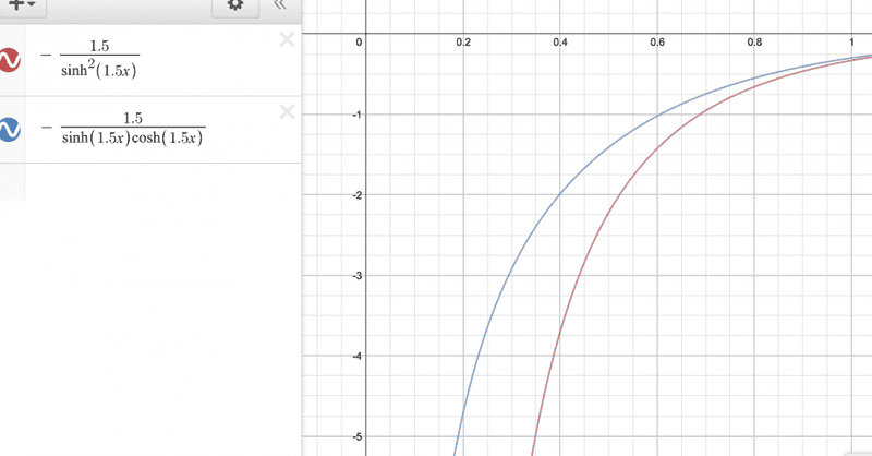

Since Chronos mentioned it, I'll try plotting the "rate of change" of H(t).
The derivative, H'(t) = dH/dt = -1.5/sinh2(1.5t) is the red curve in this picture. This keeps track of the SLOPE of the H(t) curve over time. In zeit units the present is 0.8 so we can see for much of the first half of cosmic history (up, say, to time 0.4) the slope is steeply negative compared with what it is later.
It's worth mentioning that the words "rate" and "rate of change" are vague in English and can refer to several quite different measures. They can mean "speed", or "slope". But they can also refer to the FRACTIONAL OR PERCENTAGE rate of change. So I suppose we ought to take the trouble to make clear which we are talking about.
The fractional rate of change of the Hubble constant is H'(t)/H(t), the change per unit time as a fraction of the whole, at that instant.
[tex]\frac{H'(t)}{H(t)} = \frac{-1.5}{\sinh(1.5t)\cosh(1.5t)}[/tex] This is the blue curve in the picture. Numbers on the vertical axis can be interpreted as percent change per 0.01 zeit, in other words percent change per 173 million years.
So we can see that at time 0.6 zeit H(t) was declining at rate 1% per 0.01 zeit (173 million years)
Somewhat earlier, at time 0.4 zeit, the Hubble constant was declining at rate 2% per same period of time.
And now, at time 0.8 zeit, the Hubble constant is declining at a little over half a percent per same period.
