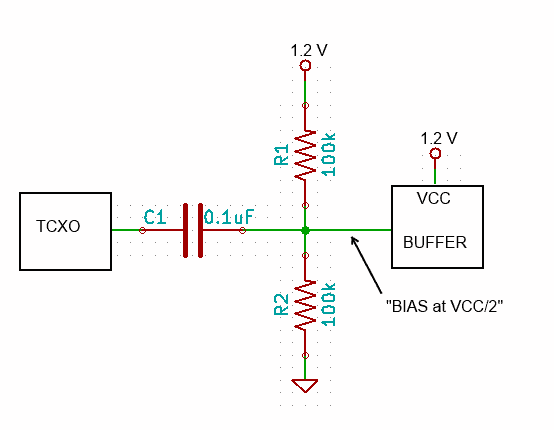

[response to post #11]:
If you want to use the IDT part, it could be made to work due to its low voltage operating range (1.2V to 1.8V), but you would need to AC couple the TCXO output to the input of this device and bias the clock (on the IDT side) at VCC/2. Also with this part, you would need to consider level shifting downstream.
The TI level shifter should work, using similar AC coupling and biasing. Since this part is not explicitly designed for clock distribution, its not clear from datasheet how much jitter, if any, this part would add (if you have a minimum jitter requirement).

@lewando: So you say using the IDT part could work in case i add a DC block in between the TCXO and the clock buffer? The chip that will be driven with the clock signal in the end is this one posted above, the R820T: http://superkuh.com/gnuradio/R820T_datasheet-Non_R-20111130_unlocked.pdf
On page 23 in the datasheet of the R820T posted above:
Input level to XTAL_in pin when using external cloc: min 120 mVp-p | max: 3300 mVp-p
So would i need a level shift in this case? As the chip seems to be able to handle pretty "low" signals.
What exactly do you mean by "biasing the clock on the IDT side with VDD/2"?
Yes, that is what I am saying. DC block and bias network.
No. If you are powering the IDT part with 1.2 V it will provide a clock with roughly 1200 mVp-p. Which is within the datasheet's spec.
Something like this:

Tom48 said:
It would output 0.75VDD (= 0.9V) min for a 'HIGH' and 0.25VDD (= 0.3V) max for a 'LOW'.
How do i know that is ok for the R820T?
(0.9 V - 0.3 V) = 0.6 V = 600 mVp-p. Within spec of the R820T.
Tom48 said:
Also if i meassure the signal provided by the oscillator, this signal must be at least 0.65VDD (= 0.78V) peak to peak (=from negative wave bottom to positive wave top), so the IDT buffer can detect the signal at its inputs, is that right?
(0.65 * 1.2 V) - (0.35 * 1.2 V) = 0.54 V "window". The TCXO is outputing something greater than 0.8 V. So you should be good.
Likes Tom48
