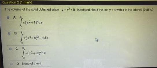

MHB Divanshu's question via email about a volume by revolution
The discussion focuses on calculating the volume of a solid formed by rotating a region around a line that serves as the lower boundary. It is noted that the volume remains unchanged if the entire region is shifted down by 4 units, allowing for rotation around the x-axis instead. The formula for the volume of revolution is provided, specifically using the integral V = ∫_a^b π[f(x)]² dx. The specific volume calculation presented is V = ∫_0^8 π(x² + 4)² dx. The approach and calculations are confirmed as correct.

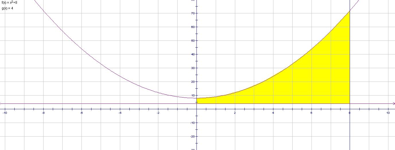

Here is a graph of the region to be rotated. Notice that it is being rotated around the same line that is the lower boundary.
The volume will be exactly the same if everything is moved down by 4 units, with the advantage of being rotated around the x-axis. So using the rule for finding the volume of a solid formed by rotating $\displaystyle \begin{align*} f(x) \end{align*}$ around the x axis: $\displaystyle \begin{align*} V = \int_a^b{ \pi\,\left[ f(x) \right] ^2\,\mathrm{d}x } \end{align*}$ the volume we want is $\displaystyle \begin{align*} V &= \int_0^8{\pi\, \left( x^2 + 4 \right) ^2 \,\mathrm{d}x } \end{align*}$.

Prove It said:
https://www.physicsforums.com/attachments/5635
https://www.physicsforums.com/attachments/5636
This is correct.
