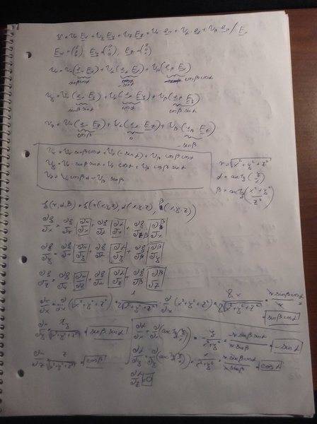

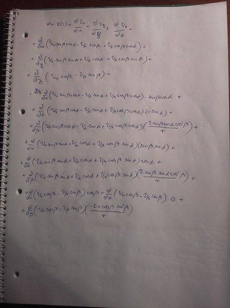

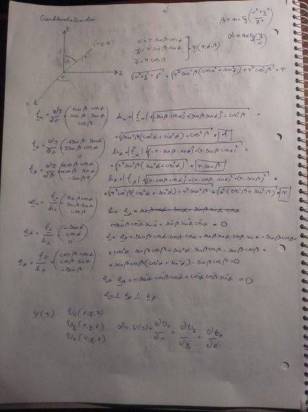

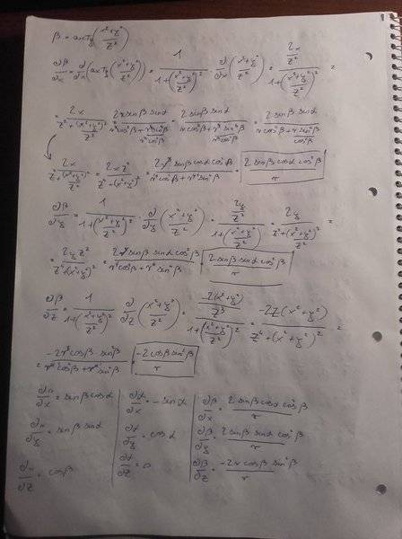

Okay, if you insist, then I would appreciate your help. :) I'll try to explain what I'm doing.
I'm starting my physics BSc degree next september (I'm studying computer science at the moment) but I decided to attend a course which is for physics students in the second semester. I'm lacking quite some knowledge that they already learned in the first semester but I'm trying to understand as much as I can. The goal of the course is to give an introduction to advanced concepts of mathematics used in theoretical physics. The first lecture was about orthogonal curvilinear coordinate systems and we calculated the divergence of a vector field in a cylindrical polar coordinate system. I decided to practice it a bit in order to understand the concept better so I started to do the same in spherical polar coordinate system. The method we learned is not the simplest one, the lecturer said the next week we're going to learn a better method.
I uploaded the pictures of what I've done so far. I hope it's readable.
Little explanation:
Page 1:
- I definine the relationship between the cartesian and the spherical polar coordinates.
- I choose the bases (to represent vectors) ##\vec{t_r}, \vec{t_\alpha}, \vec{t_\beta}## and then I set their magnitude to ##1## and name them ##\vec{e_r}, \vec{e_\alpha}, \vec{e_\beta}##
- I check if they're perpendicular to each other by their scalar product.
- I define my vector field ##\vec{v}(\vec{r})## with the components ##v_x(x, y, z), v_y(x, y, z), v_z(x, y, z)## and write the equation for the divergence.
Page 2:
- I define new unity vectors ##\vec{E_x}, \vec{E_y}, \vec{E_z}## that are aligned with the x,y,z axis.
- I represent a vector with both bases and then express the relationship of the components.
- The next problem is that I can't differentiate with respect to x, y, z as written in the divergence formula, I need to express them with the relationship between the cartesian and the spherical polar coordinates and that part with the f function is like a skeleton for how I want to do it and it gives me which derivatives to calculate. This is where I encountered with the arctan function.
Page 3:
- I continue calculating these derivatives.
Page 4:
I'm substituting everything in the divergence formula and it's waiting to be solved :D

I am sorry, but it is impossible to see what you write in those pages. Anyway, as I suspected, you have gone wrong long before the issue you posted in this thread. Based on what you are looking to do, the angle ##\beta## is the polar angle. It is not given by
\tan(\beta) = \frac{x^2+y^2}{z^2}.
Instead, I would suggest that you look back at your derivation for the coordinate expressions.

I missed a square root, so ##\beta = \arctan{\sqrt{\frac{x^2+y^2}{z^2}}}##
I haven't recalculated the derivatives yet, so in the images I still have the wrong formulas for ##\beta##

Indeed, or written a bit differently, ##\beta = \arctan\left(\rho/z\right)##, where ##\rho^2 = x^2 + y^2##. This should help you significantly in determining the derivative.
