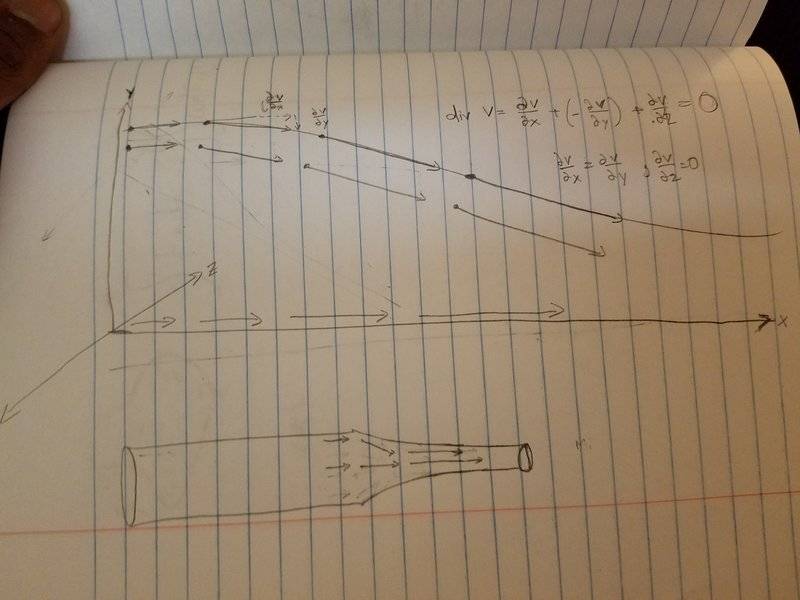

That makes sense. I am trying to get a better understanding of what it means in water flow downhill by drawing velocity vector fields. Can you check to see if my drawings are correct? I am confused about the streamlines along the surface of the slope and the streamlines in the middle of the pipe.

Each of the velocity derivatives in the divergence can be interpreted kinematically as the rate of linear strain in that direction. Just as in the case of thermal expansion, where the sum of the 3 linear strains is equal to the volumetric strain, here, the sum of the three rates of linear strain is equal to the rate of volumetric strain. But since the material is incompressible, its rate of volumetric strain is equal to zero.
