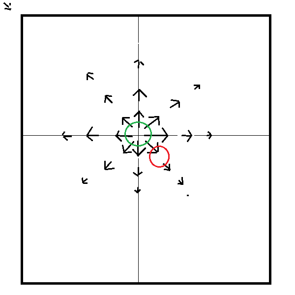

Alright guys I appreciate the replies, but there is something that I feel I need to elaborate on.
I am not disputing the fact the mathematics of the divergence, but instead the diagramming of the divergence. I have attached a picture I drew to illustrate my point.
Here there is a green circle at the origin of the electrostatic field. The charged particle acts as a source and so the divergence at r = 0 is positive. However, at the red circle larger vectors are coming into the circle than there are coming out. Based on the definition of divergence, this would seem to represent a negative divergence, not a large positive divergence as Griffith hypothesizes before introducing the delta function, nor a zero divergence as the math shows.
From Wikipedia - "In physical terms, the divergence of a three dimensional vector field is the extent to which the vector field flow behaves like a source or a sink at a given point. It is a local measure of its "outgoingness"—the extent to which there is more exiting an infinitesimal region of space than entering it. If the divergence is nonzero at some point then there must be a source or sink at that position."
There is more outgoingness at the origin, so that point has positive divergence. There is more ingoingness at the red circle, so that point has negative divergence. Can someone please elaborate on this?
You're basing your assertion on a diagram instead of a mathematical calculation. I assure you, if you integrate over any closed surface that doesn't contain the origin, you will find that the electric flux is zero, and you can take the limit of the volume becoming arbitarily small and still find that the flux is zero.
If you insist on having a conceptual explanation for this, consider that more of the area of the sphere sees outgoing instead of incoming flux (think about where the electric field becomes tangent to the sphere and how that cuts off a section that is smaller than a hemisphere for incoming flux). So while the outgoing field vectors tend to be smaller than the incoming ones, they make up for this with a larger area to exit the sphere and thus the fluxes balance.
The Coulomb field is exactly the free space Green's function for the vector derivative [itex]\nabla[/itex]. It is constructed such that its divergence is zero everywhere except for the one point where it is undefined--such that the source can be described by a delta function/distribution.
Alright Muphrid I think I get what your saying, thank you.
