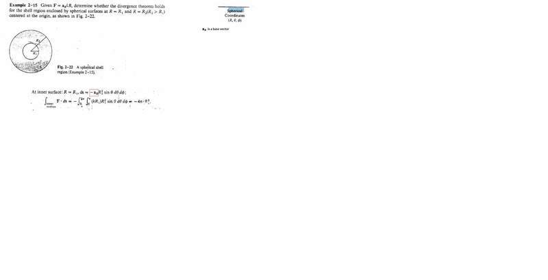

In applying the divergence theorem, the normal vector is always outwardly directed from your system.Miike012 said:The problem is in the paint doc.. My question is why is the base vector aR have a negative sign attached to it?
The Divergence Theorem, also known as Gauss's Theorem, is a mathematical principle that relates the outward flux of a vector field through a closed surface to the volume integral of the divergence of the field within the surface.
The direction of the normal vector is determined based on the orientation of the surface. If the surface is oriented outward, the normal vector points away from the surface. If the surface is oriented inward, the normal vector points towards the surface.
The correct direction of the normal vector is crucial in correctly applying the Divergence Theorem. If the normal vector is pointing in the wrong direction, the calculations for the volume integral will be incorrect and the theorem will not hold.
