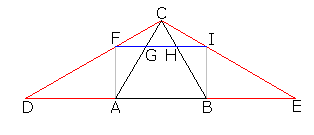

The segment AB that must divide into three parts is represented in the figure...
The following procedure requires only a non graduaded rule and a compass...
a) construct the equilateral triangle ABC...
b) construct the segments DA=AB and BE=AB collinear to AB...
c) draw the segments DC and CE...
d) draw vertical lines passing through A and B a call F and I the intersection point with the segments DC and CE...
e) draw the horizontal segment FI and call G and H the intersection points with the segments AC and BC...
At this point we have the segment FI that is equal to AB and is divided into three equal segments FG, GH and HI...
