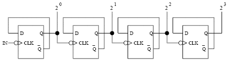

The question and provided answer are given:
I disagree with the answer. Shouldn't there only be three rising edge triggered d flip-flops?
I say this because I know if I only had one d flip-flop with the inverter, the clock frequency would be cut in half.
Similarly, I would assume that having two d-flip flops with the inverter would cut the clock frequency by 1/4.
So would I not need three d flip-flops to cut the frequency by 1/8?

You can do it several ways, but if the clock input is common to all FFs, you need a more complicated gating than mere inverters can supply.
This is an example of a synchronous counter.
If the clock inputs are freely available, you can make an asynchronous counter like this.
BTW, the solution you have been presented with is usually called a ring counter. It is simple to create, but it has several illegal states which must be dealt with - and they have not been dealt with.

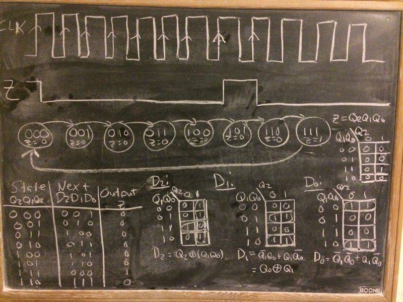

You know. After just sitting around for a while, I just made a pretty important connection between FSM design and this problem.
I realize a state graph would be appropriate, from which a state table and corresponding circuit could be derived. Since the output relies on the clock, Moore outputs would be appropriate. Here's another way of producing the circuit, it uses more gates, but it works:

"I disagree with the answer. Shouldn't there only be three rising edge triggered d flip-flops?"
Yes.
What does one D flip-flop do?
How do you connect "three rising edge triggered d flip-flops" so that they do what you want.
Please forget about synchronous counters, ring counters, binary codes, etc. All you want to do is divide by 8.

CWatters said:
The answer circuit is correct assuming that the Q output of each latch is connected to the D input of the next (and you add a reset input to all the latches).
I'm a bit puzzled. The "answer" looks like a sort of shift register, which certainly wouldn't divide by 8. I said OP was correct in saying that answer was wrong. OP's argument that one flip flpo divides by 2 , so 3 flip flops divide by 8 is exactly correct.
I still don't see what all those tables of binary codes have to do with dividing by 8. What OP needs is to take a serial pulse stream and produce a symmetric output pulse stream with 1/8 the number of pulses - no codes, no binary.
And they can do that simply with 3 D flip flops, no inverters, no gates, no feedback, no maths beyond what they've already said - 23 = 8.
If OP is still interested, maybe they could show how they divide by 2 using one D flip flop, and LABEL the input clock signal and the output clock signal.
Well, no. The "answer" is a ring counter, a simple synchronous circuit. The ring counter is characterized by:
  • Only one bit changes at each clock pulse, which means no glitches on the outputs
  • If you have n FFs, the circuit divides by 2n, not by 2n
  • If n > 2, a full circuit incorporates a watchdog circuit to eliminate illegal internal states
Yes it does.
The answer circuit is not wrong it's just different to your proposal.
Presumably you are proposing an asynchronous (aka ripple) counter? That works but has some limitations. Are you proposing to make a synchronous counter? I think you need additional gates and for this question you are only allowed inverters for free.
The answer circuit is synchronous and only uses an inverter.

You have four outputs Q1 to Q4 all of which are 1/8th of the clock. (eg they are low for four clk cycles and high for four clock cycles). The outputs are also synchronous with the input clk. The problem statement didn't limit you to three latches.
