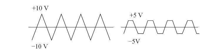

In summary, the student is trying to build a circuit to take the input waveform, on the left, and extract the output waveform on the right. In his circuit, he can only use basic diodes, resistors, and DC supplies of +10 and -10V. He has trouble understanding how his circuit would work, and has tried to simulate it but has not been able to. If the supplies were 10V, the circuit would clip the signal at +/- 10.6V. He needs to clip at +/-5 volts with a series resistor.
novop
124
Hi. I'm being asked to make a circuit to take the input waveform, on the left, and extract the output waveform on the right. In my circuit, I can only use basic diodes, resistors, and DC supplies of +10 and -10V.

In the diagram in the first post, the output is clipped at at 5V/-5V.
You need to clip at +/-5 volts.

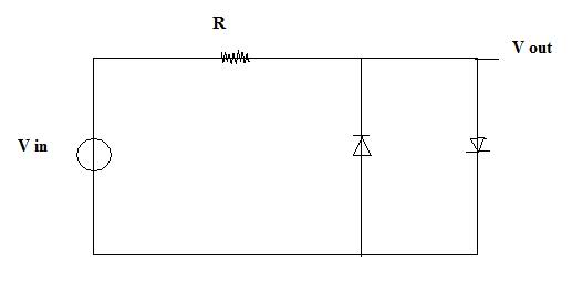

You could get close to this with 9 diodes for positive clipping and 9 for negative clipping. This would give you (9 times 0.6) or 5.4 volts. Or you could use 8 diodes to get 4.8 volts.
You have to have a series resistor to avoid excess current flow while the clipping takes place.
Something like 330 ohms.
Clipping occurs when the input exceeds 5 volts in either direction.
To get exactly 5 volts, you could take the 5.4 volts and arrange a voltage divider. This is two resistors in series from the output to ground. They need to be large compared with the 330 ohm resistor.
Clipping with diodes would give a "rounded top" type of clipping, which is useful for some applications.

I don't understanding where to make the voltage divider in this case. If, say, we take 9 diodes in each direction, for 5.4V clipping, how can I reduce this to 5V given the circuit?
[PLAIN]http://dl.dropbox.com/u/4222062/clipper%203.PNG
You would put the resistors across the output as shown above.
Since this is the homework section, I have not shown the value of the lower resistor (although I did calculate it. :) )
The 330 ohm resistor was a bit arbitrary. I just guessed a value of 15 mA peak for the diodes.
This is a value I often use for LEDs.
Good solution, vk6kro. I did have a math error in my proposed solution.
Thanks very much vk6kro. If I understand this correctly, the resistor R's value is arbitrary, it's purpose is a voltage sink after the diodes start conducting, right?
Assuming the above to be true, the bottom resistor should have a value of 12.5k ohms to extract the right waveform. Am I making sense?
Yes, that is right. In practice, you would know the load that existed after the output and could design around that.
In this case, the only load is the voltage divider.
R isn't entirely optional. You need a substantial current to ensure that the voltage drop of the diodes is about 0.6 volts.
If you chose 15 K and kept the same voltage divider, the diodes would never turn on because the voltage across them would not be greater than 4.7 volts.
Yes, I agree about the 12.5K. Good.

The 5.4 volts is only across the diodes and therefore across the two output resistors. The diodes are certainly conducting when the input voltage is greater than 5.4 volts and it is this 5.4 volts that we want to reduce to 5.0 volts.
There is a much larger current flowing in the 330 ohm resistor and most of this goes into the diode strings and then back to the bottom end of the supply. It has no effect on the voltage divider. The diode current peaks at about 15 mA.

To clarify, in the circuit attached, [tex]V_o[/tex] would be 0 for [tex]V_{in} > 0[/tex] and would be [tex]V_{in} - 0.7[/tex] for [tex]V_{in} < 0[/tex], right?
What is confusing me is that if I think of the top line as grounded and [tex]V_{in}[/tex] is connected to the bottom line, then I'm unclear as to how the diode is coming into play . . . wouldn't current simply pass through the resistor and continue to [tex]V_o[/tex]? Or does current have to flow through the diode for it to flow through the rest of the circuit as well? If so, why?On a not-exactly-related note, I built a full-wave rectifier & noticed that while the ripple is improved, the voltage is more than an additional diode drop lower (the diodes I'm using drop roughly 0.6 & the full-wave rectifier output is roughly 1.3V lower than a similar half-wave rectifier). Any thoughts as to why this would be the case?

It is usual to connect the AC source so that the wire that goes straight through to the output (without any components in it) is the common.
This would be the lower input connection in this case.
So, regard the top input connection as varying.
Any positive input won't get past the diode.
Any negative input less than 0.6 volts won't get past the diode.
Any negative input greater than 0.6 volts will be passed but with 0.6 volts subtracted from the input voltage.
I think this is what you said.
