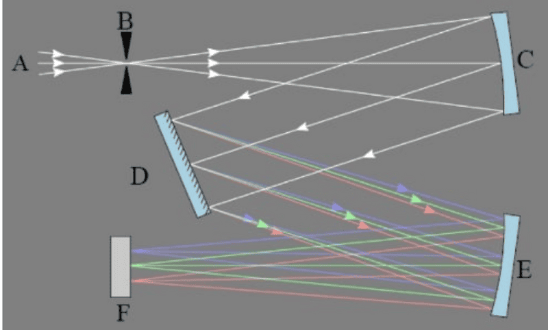

Help in modify a BW tek BTC100-2s spectrometer to improve its resolution while decreasing the spectral range.
Hello All,
I recently purchased a BW Tek BTC100-2s spectrometer from eBay. It has fairly good specifications, but I have been wondering if there is an inexpensive way to improve its resolution. The spectrometer uses a Czerny-Turner configuration. My plan was to place a slit at the focal length where the detector (F) would be, then expand that narrow section of the spectrum to fill the detector. However, I have been struggling with how to efficiently expand and focus the light after the slit onto the detector. Here are some of the specs for the spectrometer:
  • Spectral range: 400-640nm
  • Slit size: 50µm
  • Grating: 1800 lines/mm, blazed at 500nm
  • Detector: Sony ILX511 2048 Pixel CCD
  • Pixel spacing: 14µm
  • Pixel size: 200µm
Any advice or suggestions would be greatly appreciated.
Likes OmCheeto
Maybe use a different grating? One with a wider dispersion.
Or replace mirror "E" with one of different curvature (or even flat?). This would spread out the spectrum that falls on the detector.
