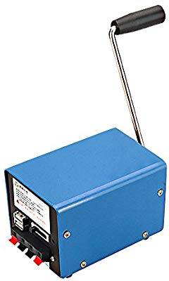

For the nano hydro power project I got now a cheap small 20w hand crank (picture attached) and replaced the hand crank with a 3d printed pelton wheel.
These are the hand cranks specifications :
Stable Power: 3v/6.6A, 5v/4A, 6v/3.3A, 9v/2.2A, 12v/1.6A, 15v/1.3A for selection
■ Max Cranking power: 20W
■ Rotating speed: 2000rmp/min
Speed: 120 RPM (Recommended)
I need some help to calculate how much kinetic energy / water speed I need to start to turn the wheel in order to calculate how much head, pipe length and pipe diameter is required.
A friend tested that one needs to hang on the handle a bag with 500ml water to bring the handle into motion. The handle is 17cm long.
The diameter of the pelton wheel is 35cm. One spoon can hold about 50ml of water.
Can someone tell me how to calculate how much kinetic energy is needed to start the crank and how much is needed to reach 120rpm? Approximately (close by) would be enough.
As well how to calculate the necessary water speed to generate the necessary kinetic energy to bring the pelton wheel into motion?
I want to check before how much head, pipe length and diameter would be necessary for that kind of wheel. Maybe it isn't feasible (to much pipe length necessary since I have head but not very steep as well difficult to maintain and protect something which is out of sightfrom monkeys playing with it etc) and cost effective and I should better change the design and switch to a classic water wheel?
Hope someone knowledgeable can help me out!
Much appreciated!

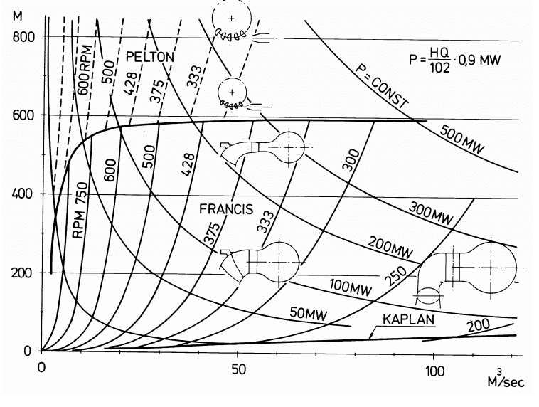

Good for you. You already did the number 1 thing that many DIY fans forget --- you reduced your power demand to a very manageable number 20 w.
Here is a very comprehensive paper on pelton wheel design
http://www.ivt.ntnu.no/ept/fag/tep4...ger/forelesninger 2006/5 - Pelton Turbine.pdf
But i fear that the paper focuses on huge projects in the 20-200 MW range rather than 20 w range. There are many articles about micro hydro DIY projects, but even those consider 5 kW as micro. 20w would be nano size. That makes it hard to find precedents.
Hydro plants use head in m and volume flow rate ##\frac{m^3}{s}## as the primary parameters, not kinetic energy. Let's start there. What do you have available?
  • How much flow? ##\frac{m^3}{s}##
  • How much head? m
