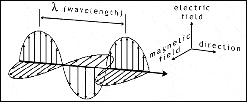

Light moves in a straight line. What has an oscillation is the electric and magnetic fields. When someone draws light like this
notice that only one of the axes represents space.
In vacuum, the speed on light is constant, whatever the frequency and amplitude of this oscillation.

I was under the idea that light traveled in a spiral, slinky, corkscrew like wave or at least that what I have been able to learn off the net so far...
so the photon travels strate and it gives off electric and magnetic fields with different frequency and amplitude of this oscillation.
am I getting the right idea maybe ??
That corkscrew picture probably corresponds to circular polarization of light. But there is nothing doing that motion in space.

This really depends on the photon's energy. All photons have the shape of the picture above. But all photons can also be treated as a particle (and higher energy photons are more particle-like). This is called wave-particle duality and you should read more about it.

No, you cannot think of a photon as having a shape. It is not a particle in the sense that it is a little ball or some other shape. It is simply a quantized interaction between the EM wave and matter or another EM wave.
Likes hsdrop and Dale
Wave-particle duality is an outdated concept and you shouldn't get that much into it. And what you wrote about shape of photon is completely not true. There is no meaningful way to talk about shape of elementary particles.

So the short answer is no because they don't physically "move in a wave like pattern".

What if the photon doesn't have anything to interact with and is just propagating through space? Would it not be like the picture in post 2?
No. However, you've asked a very similar question in another thread: https://www.physicsforums.com/threa...er-interacts-with-matter.894667/#post-5628310
