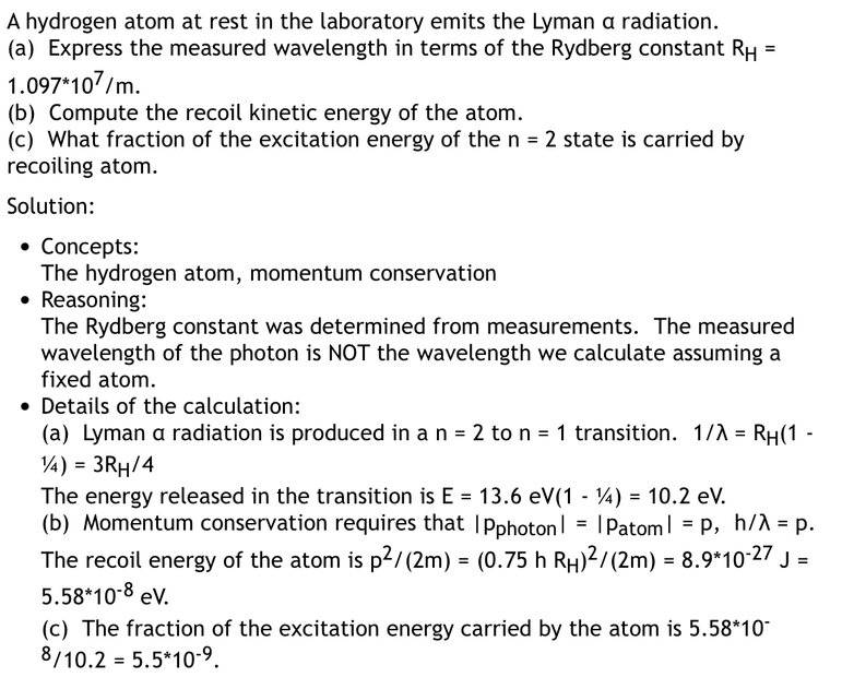

Here I found some calculations. As I see the momentum of the recoiled atom is very small. Are there any known experiments that has confirmed this?
Where? Please give a reference. You can't just post something and not tell us where it comes from.
No, the energy of the recoiled atom is very small compared to the energy of the emitted photon.
The momentum of the recoiled atom is exactly equal in magnitude (and opposite in direction) to the momentum of the emitted photon; this must be true by conservation of momentum.

I wonder is that recoil enough since it is very small, is that enough to amount for the Maxwell Boltzmann distribution?
No. The calculation you gave in post #5 makes that clear; the recoil energies are much smaller than thermal energies.

sol47739 said:
Was Dale Right that the recoil is negible?
Yes. Once again, the reference you yourself gave in post #5 clearly shows that. Did you actually read what it said?
