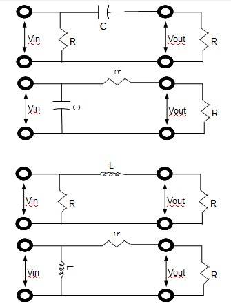

OK, I want you to consider the four variations of a simple circuit above. A voltage source Vin supplies the circuit. The output Vout is measured. The two resistances R are equal.
Now introduce the idea of impedance Z in AC circuits. Z can be any combination of resistive (R), capacitive (1/wC), and inductive (wL). No matter what combination, Ohm's law V=I*Z applies. w is proportional to the frequency. For low frequencies (almost DC) 1/wC is very large and wL is very small. For high frequencies, 1/wC is very small and wL is very large.
Now, can you tell what happens in each of the four circuits for two cases? First case, Vin is low frequency. Second case, Vin is high frequency. Don't worry about numbers, just think about Vout. How big will Vout be compared to Vin?

well your circuits are low pass and high pass filters because impedance of the components change at different frequencies.
What happens when you connect a dc battery to a capacitor? will the capacitor charge and then discharge after the capacitor voltage=battery voltage.?

Good.
An ideal capacitor connected to a battery will charge to battery voltage. When disconnected, it holds the charge. Real life capacitors have leakage which will discharge it slowly.
In each of the 4 variations, you include a component connected from Vin to ground (drawn very close to the left side). Should we pay any heed to this component?
There is no ground in those drawings. Arrows just show where Vin and Vout are measured. They are not part of the circuit.
There is nothing of significance in my use of "ground", I could instead refer to your schematic's lower-most conductor as the common rail. The question concerning the component I identified still holds.
In each case, there is an R or C or L connected across the input. Is that what you mean? Sure they are significant. The L Shortsout the circuit at DC and the C shorts it out for high frequencies.
As I said in #12, the arrows showing how Vin is measures are not components of the circuit.
Otherwise, I'm confused about what components you are asking about.
A DC source would not like you putting a short across its terminals. For similar reasons, a high frequency source would be expected to react badly if you in effect directly "short" its terminals with a large capacitor as you propose.
I'm not proposing anything practical. I was trying to explain principles using ideal components. No real life involved.
But I never said DC or infinite frequency, I merely said low or high frequencies.
Talking ideal components, adding R or L or C directly across Vin will have no effect on Vout in your circuits.
Ah yes, you're right. Good point.
