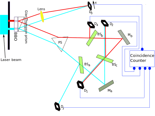

Well yes... but I’m a little 'skeptical'... those little "bastards" seems to be very sensitive for "exposure"...
If you compare with e.g. the http://en.wikipedia.org/wiki/Delayed_choice_quantum_eraser" they definitely don’t want to play...
Are you sure it can ever work...?
P.S. You really got me with your user name! Spent quite awhile wondering what 3,735,928,559 could "mean"...? ∏√0xDEADBEEF = 1 ?? Nice 'trick' DeadBeef! (I must be completely stupid...) :smile:
In that experiment they look especially robust, as they keep their coherence even though you do all that parametric down conversion stuff.
Considering that you can even run quantum algorithms in NMR, I am sure that you can do that spin flip too.
