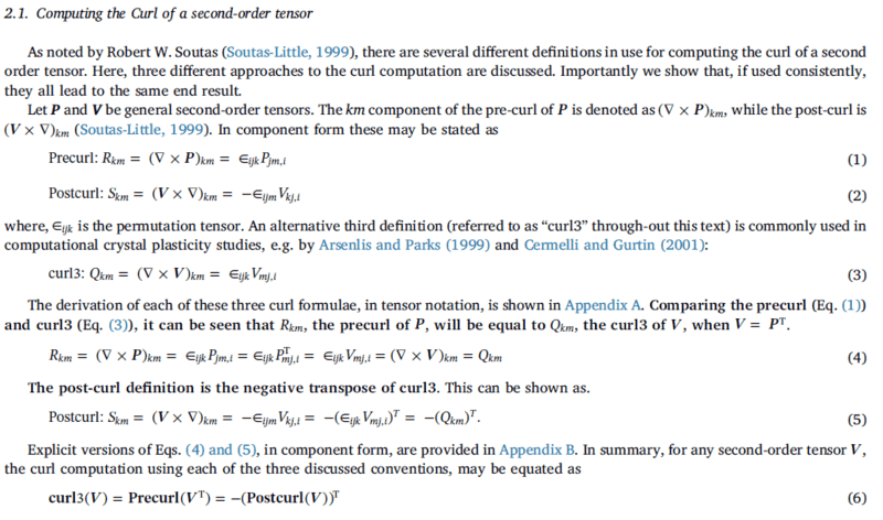

Firstly, thank you for sticking with me and helping me with these concepts. We are not super well trained in these mathematic topics in the mechanical engineering field so we have to try to learn it on our own and there are so many different notations especially when used in a different discipline, such as our field of continuum computational mechanics.
I think I am slowly appreciating what you are saying here. In a journal paper I found before, I read the following:
The precurl and postcurl defined here seems to me very similar to the concept that you have been reiterating about which index to which apply the curl. As also stated in this paper, for our purposes, all of the types of curls lead to the same result, I believe this is because the tensors are symmetric, i.e. ##R_{ij} = R_{ji}##, so the index choice doesn't matter computationally speaking. Nevertheless, I should be consistent and clear in which definition I use.
So, if I have learned anything from our discussion so far, hopefully, the following equations are now correct:

Yes, these expressions are much better in terms of indices. My only beef with their notation is that in most standard notation, a differential operator acts on what is to its right so the ”postcurl” notation is rather eye popping. I guess if one can live woth that … Regardless, I would generally try to avoid calling this curl and using index notation will not risk any such issues. As always, the notation risks going haywire for higher rank tensors.
That said, with these definitions, the curl is indeed a contraction of the gradient with the Levi-Civita symbol.
