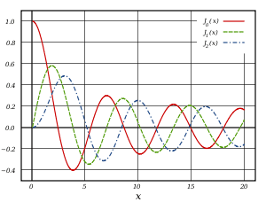

Ideally, a collimated Bessel light beam is non-diffractive, and therefore not divergent over distance in vacuum. This is also true of a phased array of antenna. The aperture is also of infinite diameter (the complete Bessel function), so it is only approximated. An antenna array is of discrete sources, even with smoothing techniques, is already an approximation to a Bessel function, and at a disadvantage already.
In a phased array antenna (or a laser, surely), there will be a distance, beyond which the spreading loss is inverse square. How can there not be an effective sinx/x type diffraction pattern to the emerging beam?
You're right, of course. No matter how careful you are, there is still a far field.
The sinx/x relation of obtained for a beam intensity constant in phase and amplitude across the aperture, as you know. In answer to the question, "what beam profile at the aperture is non-dispersive?" any of these curves is the solution for radial intensity of the source.
First order Bessel functions. Also see Wikipedia Bessel beam.
Bessel beams require an infinite amount of power, and infinitely large aperture, and so cannot be produced in reality. I could say, tongue-in-cheekly, that the power and aperture size of actual lasers is considerably smaller than the quantities I mentioned in the previous sentence :smile:
As born2bwire said in Post #2, actual laser beams will diverge, due to diffraction, after a distance comparable to D2 (or less). Laser beam divergence is often measured in milliradians, so it is small but nonetheless the irradiance does diminish as 1/r2.
Yes, of course, Redbelly.
It's very disappointing that the Bessel functions don't decay faster so to better be approximated over a finite aperture. However, notice that J1 and J2 are nearly out of phase in the tails. Does this persist? I wounder if J1+J2 is not also a non-dispersive solution, and so far better approximated over an aperture of the same radius used for either J1 or J2, alone.
