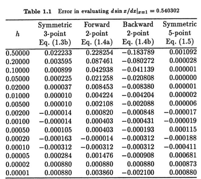

Dilema said:
In analogy to mathematics. It is much easier to obtain a derivative than to integrate.:smile: The analog is a "derivation" of a phenomenon:wink:
You should investigate numerical differentiation v. numerical quadrature. :wink:
  • #31
nikkkom said:
Google NWFAQ. A very good read on shocks.
I 'Googled' and got a vast list of hits. If you could be a bit more specific then I could perhaps read what you are referring to.
  • #32
tech99 said:
The heads of the waves stand up out of shelter and are pushed by the wind.
Under some circumstances, yes but you do not need much wind at all for a wave to break. The wind can even be offshore. The effect of breaking is more to do with the bottom section slowing down than the top section accelerating.
  • #33

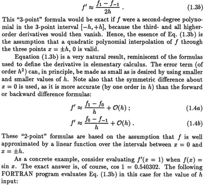

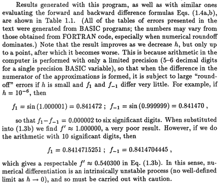

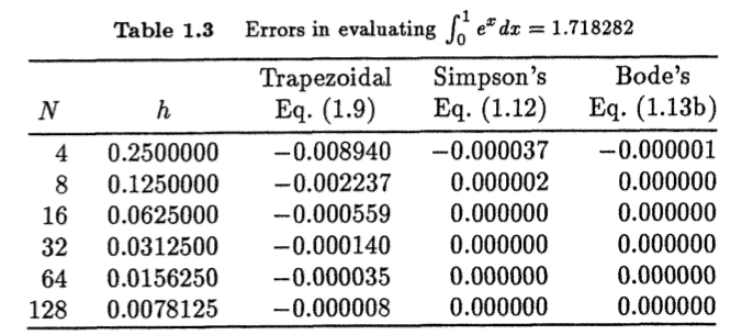

Computational texts will do it far more justice than I can, but, to use my own term, differentition is 'flaky' with regard to the step-sized used. See attached images:
It is common for textbooks (especially old ones like Computational Physics by Koonin and Meredith from ~1970 and before symbolic computing from which the images are from) to highly discourage computational differentiation if possible.
Let me know if it is still unclear and I can maybe find a better explanation from text.
  • #34
Those numbers really don't help me at all. A bit of context about shock waves would be appropriate.
  • #35
The behavior of the error (going from positive to negative is of interest here. Also the error for integration converges to 0 for much larger values of h).
This is a mild digression from shockwaves, but in direct reply to OP's statement in the quoted post.
