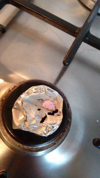

Objects which are strongly coloured may show other colours, e.g. Erbium oxide glows green!
Edit: As Erbiumoxide is quite a common compound in a nerd's household, I had to try this out, as I have never seen it. The effect is indeed spectacular, although the photo is not as impressive. The green colour can best be seen in thre reflections on the aluminium dish.Green is roughly the complementary colour of the pink of the oxide at normal temperatures.
Likes eyad-996

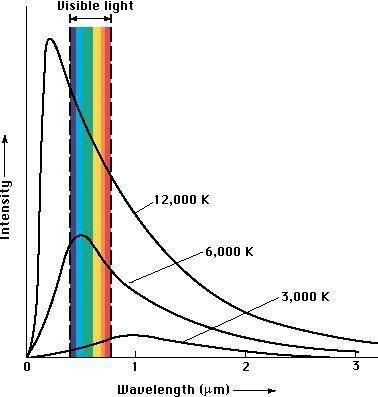

Could you help me understand this better.
Here's what I got from it.
At 3000k the wavelength of the radiation being emitted from an object peaks in the infrared part of the spectrum. We see the red color because at 3000k it has its highest intensity inside the visible part where the red color is, right?
At 6000k it peaks inside the visible part of the spectrum, and it's where the color is blue. But here, at 6000k, the intensity of the light emitted is way greater than at 3000k, so we should see a brighter blue than the previous red, right?
Can the absence of a green in the color temperature scale be explained using this picture?
DrClaude already explained you why. When the frequency with maximal intensity corresponds to green, the spectrum is so broad and flat (we are at a maximum!), that we have the impression of white.
