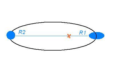

What I think is that the shape of the planet changes along its orbit, so the angular momentum changes. Look at the figure, and assume that the planet does not rotate with respect the Sun. The angular momentum L=Iω is conserved, but then the angular velocity changes if the moment of inertia changes. It gets increased at perihelion, so ω gets slower than that of a rigid planet. The centripetal force needs to be less, the perihelion distance of the planet increases.
Nice idea :)
But... it seems to me the perihelion distance would only increase relative to that of a perfectly rigid body (in an otherwise identical situation).
In other words, I think this effect would not cause the perihelion distance to increase over time.
What do you think?
What do you think?
Well, it was just an idea. And thinking of the centripetal force at perihelion, mrω2 (r is the radius of the curvature of the orbit), it is equal to GmM/R12 , r should increase as ω decreases even when the perihelion distance stays the same. Increasing the radius of curvature means the "peak" of orbit getting flatter .
You should solve the equation of planetary motion for a non-rigid planet to see, how its orbit evolves in time... :)
