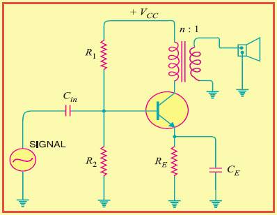

you'll start with the basic class A amplifier
where current through the device varies above and below its quiescent(zero signal) value..
that's how it makes AC.
In that circuit the transformer decouples the DC , of course.
plenty of tutorials out there, these images are from https://www.elprocus.com/class-amplifier-circuit-working-applications/

In general transistors only work in certain "quadrants" for example an NPN needs the base to be positive wrt the emitter so it can't amplify a negative voltage (it would switch off). To get around this the base is biased (a DC offset is added to the AC input) so that its always positive wrt the emitter. That's what Jim's second diagram is showing you.
