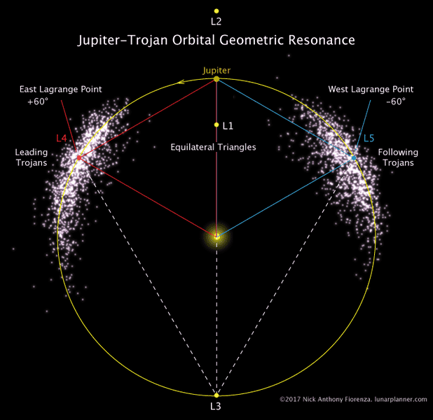

In a volume with dimensions on the order of millions to billions of miles,.Jupiter moving 1000 miles over its orbit is nothing.Here's a (very) rough diagram of Jupiter's Trojans.
See if you can draw Jupiter moving 1000 miles away over the course of its year.
(Hint: 1000 miles is on the order of a millionth of a pixel.
or: you would have to blow this picture up until it was about 63 miles in diameter before you would see a single pixel change over the course of a Jovian year.)
This diagram is of Jupiter's present day stable orbit, after it's finished migrating...But let's take a look at it and see if we notice something of significance. As you say -
the Lagrangian points - which range from … a billion and a half miles along it's orbit.
Yet in the diagram you can see that the Lagrangian points are very well defined geometrically as being sixty degrees ahead of and behind Jupiter in it's orbit, making equilateral triangles with Jupiter and the Sun. Only we see the asteroids spread out over a long distance in the orbit. Does this mean that the region of stability extends throughout this region? No! So then what is happening? It turns out that Jupiter, with it's Trojan asteroids, at a distance of 5 A.U. from the sun and an orbital period of ten years, pass by Saturn, at a distance of 10 A.U. and period of thirty years. Every time the leading edge of the Trojans approach Saturn, Saturn's gravity tugs on them causing them to advance a little more along their orbit, and every time the trailing edge passes by Saturn it's motion is retarded a little bit, and the cumulative effect of this is to cause the Trojans to spread out in their orbit. It's a type of tidal force called dynamical friction. By the way,
