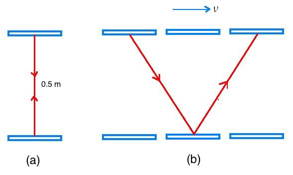

Hopefully this is on-topic enough to post in this thread and not create a new one... sorry to the OP if I'm taking anything away, but, to the experts...
With the example of a moving photon clock, the clock is measuring time dilation in that it takes longer for the clock to register a "tick" because of the increased distance the photon has to travel. I'm probably misinformed somehow in my reasoning, but can you somehow say that the clock is measuring distance? Is this kind of what is meant by saying space and time are one, not separate?
And in G.R. time dilation occurs because of stretching of space? Does this mean that for a stationary photon clock, the distance between where the photon is emitted and the mirror is greater(stretched)? Causing it to take longer to register "ticks?"
