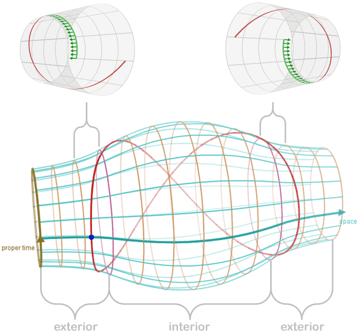

Note, that even in Newtonian mechanics you can have objects with proper acceleration towards each other, yet not moving towards each other (objects on opposite sides of a turn table).
General Relativity allows the same (without rotation) in the opposite direction (away from each other). This is only possible if spacetime is curved between the objects.
This is what is looks like locally in a frame at the surface (note that there is no intrinsic spacetime curvature yet):
And this is the global picture that connects the local geometries, and has intrinsic spacetime curvature:
Note that the free falling wordline always deviates towards the "more stretched" proper time, which corresponds to greater gravitational time dilation (along its gradient). Gravitational time dilation has an extreme point at the center of the mass (gradient is zero), so there is no gravity there (but the maximal gravitational time dilation).
