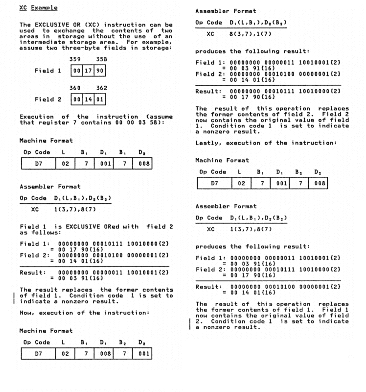

From: https://en.wikipedia.org/wiki/XOR_swap_algorithm#The_algorithm
PseudocodeIBM System/370 assemblyx86 assembly
X := X XOR YXR R1,R2xor eax, ebx
Y := Y XOR XXR R2,R1xor ebx, eax
However, the algorithm fails if x and y use the same storage location, since the value stored in that location will be zeroed out by the first XOR instruction, and then remain zero; it will not be "swapped with itself". This is not the same as if x and y have the same values. The trouble only comes when x and y use the same storage location, in which case their values must already be equal. That is, if x and y use the same storage location, then the line:
X := X XOR Y
sets x to zero (because x = y so X XOR Y is zero) and sets y to zero (since it uses the same storage location), causing x and y to lose their original values.
I made minor edits to the Wikipedia article ##-## among the edits was insertion of the underlined (not underlined in the Wikipedia article) part below:
However, in the pseudocode or high-level language version or implementation, the algorithm fails if x and y use the same storage location,​
If the two registers have the same content, XR R1,R2 will zero out R1, and will leave R2 unchanged, so the failure denoted does not occur in the illustrated assembly language code.

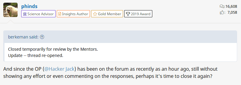

berkeman said:
Closed temporarily for review by the Mentors.
Update -- thread re-opened.
And since the OP (@Hacker Jack) has been on the forum as recently as an hour ago, still without showing any effort or even commenting on the responses, perhaps it's time to close it again?
Sorry dawg I am reading the answers but don't really like to reply back unless I have a question but the way this thread and others dive into other deeper topics I don't know what they are talking about so another reason I don't reply. My question has been answered I guess but I just let people keep talking about whatever they are talking about. Sorry about that.
Likes phinds

In IBM mainframe assembly language, the register swap ##-##
XR R1,R2
XR R2,R1
XR R1,R2
##-## is fine for swapping register-length pointers to records; to swap the records themselves, we would use ##-##
XC A,B
XC B,A
XC A,B
##-## and neither of those would pose a problem if the two XORed objects were to start out with equal values ##-## as you pointed out, if they were to start out equal, then they would wind up equal.
The precaution of ensuring inequality prior to doing the swap was for the HLL case described.
A further elaboration:
From the IBM System/370 Principles of Operation manual:
From the Notes for that section of that manual:
4. A field EXCLUSIVE ORed with itself is cleared to zeros.
The example refers to two different memory locations ##-## if the two operands were to reference the same memory location, the first of the three XC instructions would zero out that location, and so, superfluously, would the second and the third of them, there being only one location referenced to begin with ##-## hence the precaution of ensuring inequality prior to doing the swap ##-## the three-XOR swap technique cannot be used for the purpose of inplace swapping of a value with itself ##-## XORing something against itself always results in a value of zero.
