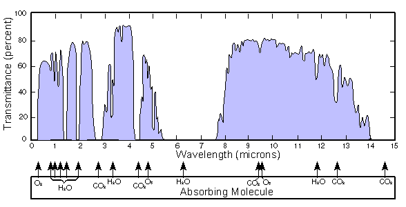

I get the impression that you are treating air as a chemically uniform medium. It is far from that. Water vapor and CO2, among other components, contribute significantly to the transmission spectrum of Earth's atmosphere within the infrared spectral domain. See for example:

The thing is I don't accept graphics, I accept equations and definitions.
My question is: How do you define air emissivity ?
Since we are defining emissivity to differenciate how radiates finite surface bodies at the same temperature but different composition, how can I define the emissivity of a shell of air (+ CO2 + ionized O2 in very small quantity and so on) called atmosphere ? The emissivity should be define with a step a refractive index, as Kirchhoff's law suggest.
Then, to perform the integration of radiative transfer theory, the "emissivity of air" should depend on altitude, because the gas density decrease with altitude. Can you give me the expression of the emissivity of air depending on the altitude ? I tell you this because according to climate people (I don't say physicist I say people) we should consider every layers of air to emit as a grey body with different emissivity... which should depend on $z$.
