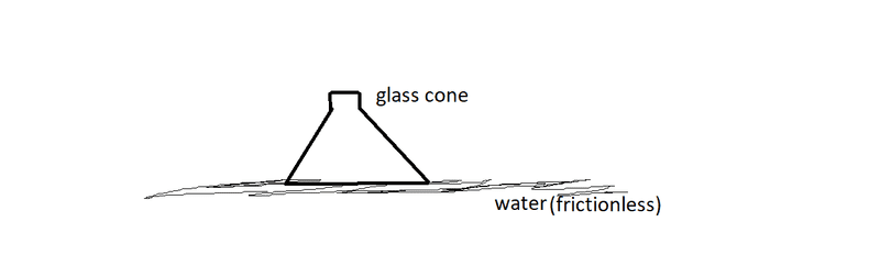

I tried to do an experiment with coin and pencil but I couldn't see the required phenomenon.
But I have done an experiment with glass cone on a glass table also. I put water and so the surface became frictionless but I was unable to apply same force everytime. I am thinking how can I achieve this. I will try with balloon in air also.
