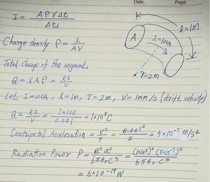

The drift velocity is more around ~1mm/s. But that's not the point. As discussed before, stationary sources don't produce radiation fields. If you can describe a situation by a DC, nothing radiates.
The fluctuations due to thermal motion of the atoms/molecules/electrons within the matter of course cause thermal ("Planck") radiation.

Maybe there's something I haven't figured out yet, but anyway I'm assuming that the radiation from the acceleration of the charge in a small section of wire in the DC circuit isn't canceled out, and did a very rough estimate of the radiation it produces.

I believe it. Why shouldn't I? The multipole moments of time-independent charge-current distributions, however are also time-independent. So there's no contradiction.
Since I don't understand why in a DC circuit with arbitrarily complex spatial structure, how can the radiation of many single accelerated electrons cancel each other out. So I searched the Internet and found another physics discussion site, someone said that the radiation generated by the acceleration caused by the curved path is too small to measure, because the drift speed of the electrons is too low, and several replies agreed with him. I thought it made sense, So I made that argument here as well.
But after reading the valuable replies from the experts here, I reconsidered and felt I should revise my thinking a little more 😥, this claim that the radiation is too low to detect is unnecessary and probably not true.
Now I think of another simple and intuitive way of explaining it. I don't have to imagine how the electromagnetic fields cancel each other out from the whole complex structure of space circuits. I only need to consider the local current element. Although there is charge acceleration in the local current element, since the charge in the DC circuit flows continuously and stably, when the charges accelerates away from a place, it is instantly replenished by other charges without interruption, so this acceleration will not cause change in the distribution of charge anywhere in the circuit, nor does it result in a change in current flow in any direction throughout the circuit. So the final conclusion is that there is no electromagnetic radiation😌.
