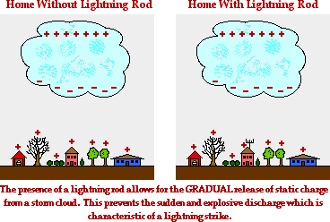

What about this picture (found here, slide 8):
Isn't this exactly what I mean? And the lightning rod even has many spikes as Dotini mentioned.
That graphic may not be entirely correct, or complete. As I understand it, the electric field between the Earth and sky goes all the way up, past the clouds, to the electrosphere. The thundercloud has its own electric field. Corona discharge from the Earth is balancing the main field, and more sharp points from lightning rods may help that, but it's not easy to quantify. Corona discharge from the lightning rod may have an effect on the electric field contained within the cloud, but that too is not easy to analyze. It's said that raising positive charge is the same as lowering negative charge, which is what the graphic on the right indicates is happening between the cloud and the ground. It may be that a bunch of multi-pointed lightning rods could reduce the general electric field in an area and reduce the chance of lightning, so that is an hypothesis that could be tested. But I'm no expert in weather control, and I'm unaware of any such experiment.

Agree with Dotini
that graphic is totally incorrect ... the lightning rod DOESNT provide a path for show discharge from the cloud
rather it provides a safer alternative path for the discharge that is going to happen anyway, regardless of if the rod is there or notDave

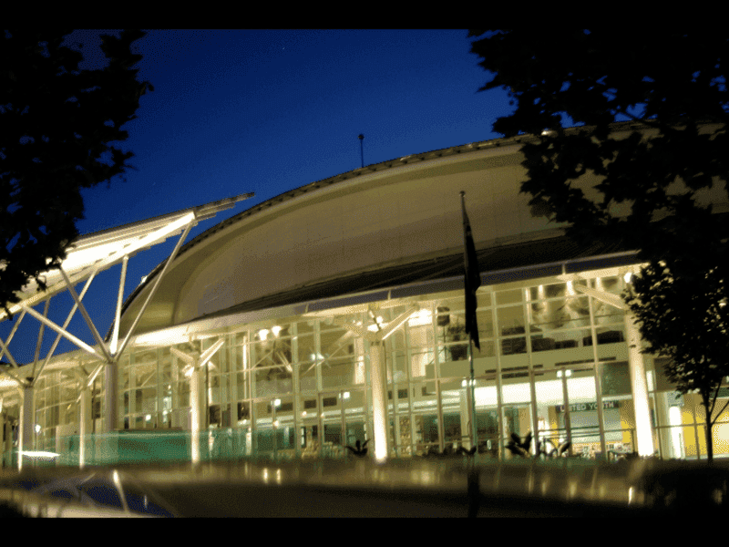

When I worked in the radio telecoms industry, ALL our lightning rods on radio masts were reasonably blunt ended. 6ft long 2" diameter galvanised iron with a sealed off flat end cap.
here's one of those globe examples close to home ...
Dave
