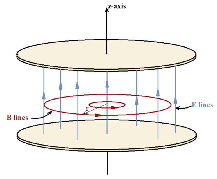

For a specific example, consider the ##E## and ##B## fields produced by charging parallel, circular plates:
The lower plate is being charged positive while the upper plate is being charged negative. Neglecting edge effects, the E field is parallel to the z-axis and is increasing in strength while the ##B## field lines are circular. We assume that the rate of charging is controlled such that the magnitude of ##B## at any point increases linearly with time. Then the ##E## field turns out to be nonuniform in space and increases quadratically in time. The magnitudes of the fields may be expressed as $$E = at^2 + \frac{ar^2}{2c^2}$$ $$B = \frac{art}{c^2} .$$ Here, ##a## is a constant with dimensions of electric field divided by time squared.
##r## is the horizontal distance of a point from the z-axis.
It can be checked that these fields satisfy all 4 of Maxwell’s equations. ##B## increases linearly with time. ##E## contains a time-dependent term (quadratic in ##t##) which is uniform in space and a time-independent term that is nonuniform in space (quadratic in ##r##). These two terms correspond to the right-hand side of @pasmith 's
pasmith said:
$$\mathbf{E} = \frac{c^2t^2}{2} (\nabla \times \mathbf{b}) + \mathbf{E}_0(\mathbf{x})$$
In the figure, you can see how the ##B## field “curls” around the changing E field.
Even though the ##E## field lines are straight, the ##E## field nevertheless has a nonzero curl (in the mathematical sense) around the changing ##B## field. This is due to the increase in ##E## as ##r## increases.
