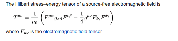

Yes I have looked at both wikipedia articles suggested by Peter Donis and Dale. I'm not trying to waste your time and just ignoring the links you provide.
This formula (screenshot 1) taken from Wikipedia (https://en.wikipedia.org/wiki/Electromagnetic_stress–energy_tensor)
- - - - - - - -is the same as this formula (screenshot 2) from Wikipedia (https://en.wikipedia.org/wiki/Stress–energy_tensor#)
The first one is in flat space, so g = Eta . The second Wikipedia article directly states "of a source-free electromagnetic field" as shown in the screenshot above.
I can only apologise if I got this wrong. I was probably looking at the other article at the time.
