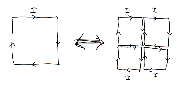

I'm asking the above question as I imagined a current loop made out of a curving wire that cannot fit into a flat plane.
Where does the direction of μ point then?
Also, is there only one μ value for any current loop, independent of the chosen axis of tilting?
Or can a current loop have different values of μ depending on the angular position of the axis of tilting?
The angular positions lie in a plane perpendicular to the external uniform magnetic field.
The axis is parallel to that plane and also perpendicular to the B field. A current loop will experience a torque about the axis.
An arbitrary shaped and oriented current loop can be thought of as a sum of small flat current loops. Each small current loop has a magnetic dipole moment with a magnitude equal to the curremt times the area and a direction given by the right hand rule. The total magnetic dipole moment is then the vector sum of the individual moments

Am I right to say that from here we can see that it is impossible for one current loop to have two different values of mu?
I am not sure what you mean by two different values of μ. Any loop has one magnetic dipole moment. Different parts of the loop can be considered to effectively have a separate dipole moment, but the entire loop has one dipole moment. I have attached a Word doc. of a simple case of a non-planar loop showing how the total dipole moment can be calculated.
think of a single loop, but you tilt it at different axes. Is the mu the same for all axes? For axes at all angles possible.
The definition of the magnetic dipole moment of a simple loop is: μ = I A, where A is the vector area perpendicular to the plane of the loop. So if you tilt the loop, the vector changes direction, and the dipole moment is no longer the same.
Okay.
How do we prove that the mu of two loops combined is just the vector sum of their individual mu?

vanhees71 said:
It doesn't make sense to consider different parts of a current loop. You must always have a closed loop,
I suspect that Chandra is thinking of something like this:
where the loops on the right are infinitesimally close to each other.
Absolutely.
I don't get what you are after. Of course you can always use such a construction, but it doesn't change anything. The inner paths cancel each other. It's used in the standard proof of Stokes's Law and for the definition of the vector-derivative operator "curl=##\vec{\nabla} \times ##".

tade said:
Okay.
So Stoke's Law is essential to the proof that the mu of two loops combined is just the vector sum of their individual mu?
