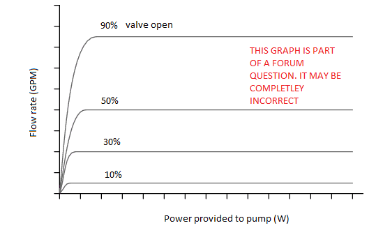

Hi everyone,
I am an electrical engineering student and in my free time, I make educational youtube videos about electronics. (youtube.com/SolidStateWorkshop). I'm working on a video right now about transistors. To help explain their operation, I am attempting to use a hydraulic circuit consisting of a pump and a valve. If you'd like to know more about how i plan on doing that, I can elaborate but I don't want to confuse transistors with fluid dynamics at the moment.
I would like to know if a pump (perhaps a centrifugal type) has a maximum flow rate it can produce for a given system. Is there a point at which increasing power to the pump (ie trying to increase its RPM) will NOT result in a greater flow rate? I'm assuming there is some sort of "variable-power controller" for the pump. I'm guessing that by incrementally increasing power, you will not see a linear increase in flow rate. As flow rate increases, resistance (back pressure?) increases and thus more power is required to move the water. If the power is being limited, then the flow rate is also limited. I'm probably like 900% wrong though...
I've attached a graph of what I am after. I am curious if such a relationship exists in fluid dynamics or if there are other factors that will make a hydraulic system behave very differently from an electric one.
Thanks in advance.
Tim
QUOTE="TimNJ, post: 5197049, member: 488196"]I would like to know if a pump (perhaps a centrifugal type) has a maximum flow rate it can produce for a given system.[/QUOTE]In the real world, there would be flow from the outlet at a higher pressure back to the inlet at a lower pressure from the certain features of pump design, such as the clearance of the pump tip blades with its casing. So in the real world a pump has a maximum pressure that it can produce. But at maximum pressure, flow is zero so power output of the pump is also zero. That is not to say power input from the pump shaft is zero. Power input to the pump and power output of the pump are 2 different things, and determine the efficiency at which the pump is operating.

Absolutely wonderful response. Thank you so much. I understand that power is a product of two quantities. I'm assuming that the magical power regulator box has a method of varying power. In simplest terms, I take it that pressure is determined by the system the pump is attached to (valves, heat exchanges, pipes). Increasing flow rate subsequently increases pressure. If the pump was unregulated, it would likely consume more and more current (because it needs more power). But if power is the independent variable, then, the flow rate follows a cube root relationship where increasing power by a set amount has less and less effect on the flow rate. Hope that's about right!
