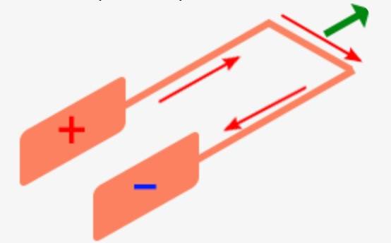

Hi.
I had a question about railguns, but I think I can formulate the underlying problem more clearly and concisely, hence I'm opening a different thread.
Consider the following rigid arrangement of three pieces of wire and two parallel capacitor plates:
There's an open switch somewhere in the wire and the capacitor is charged using an external voltage source, which is then removed. Then the switch is closed. This will start a current to flow in the direction indicated. The parallel pieces of wire both create a magnetic field that points downwards at every point of the transverse wire (maybe only approximately, since the wire pieces are finite). This causes a Lorentz force in the direction of the green arrow.
If I'm not missing anything, all other forces cancel due to the rigidity of the arrangement. This seems to violate conservation of momentum. I can see two ways out here:
  1. The loop really start to move and there's opposite momentum carried away by the EM-field.
  2. This arrangement reminds me suspiciously of the thought experiments that lead to displacement current. Since the electric field between the plates decreases, there is indeed displacement current there and it's directed opposite the current in the transverse wire.
    Now, does Lorentz force also act on displacement currents? I have never heard of that, but that could potentially compensate the green force.
So, what's happening here?

I'll rephrase the experiment:
  1. Assume there's an open switch somewhere in the wire.
  2. The capacitor is charged using an external voltage source, which is then removed.
  3. The switch is closed. Current flows, the parallel wires create a magnetic field that is directed downwards at every point of the crosspiece (maybe only approximately, since the wire pieces are finite).
  4. This causes the green Lorentz force which accelerates the projectile.
The question remains, how does this not violate conservation of momentum?

I don't see the link to the problem in this post. There just isn't anything around, no matter how heavy, and the orange structure seems to accelerate without throwing away parts.
Or equivalently, what is the Third Law partner of the force on the transverse segment?

But the whole thing is rigid. The transverse piece is fixed to the parallel wires!
Yes, but it’s same force that needs a third law partner and that third law partner is the same force as the recoil force in a railgun. Your rigid structure is an instantaneous snapshot of a railgun at the moment of firing before the projectile has started to move.
Likes topsquark
So, in short, what happens when the switch is closed?
  • Does it accelerate?
  • Or does it not?
  • Or does it not?
It does not.

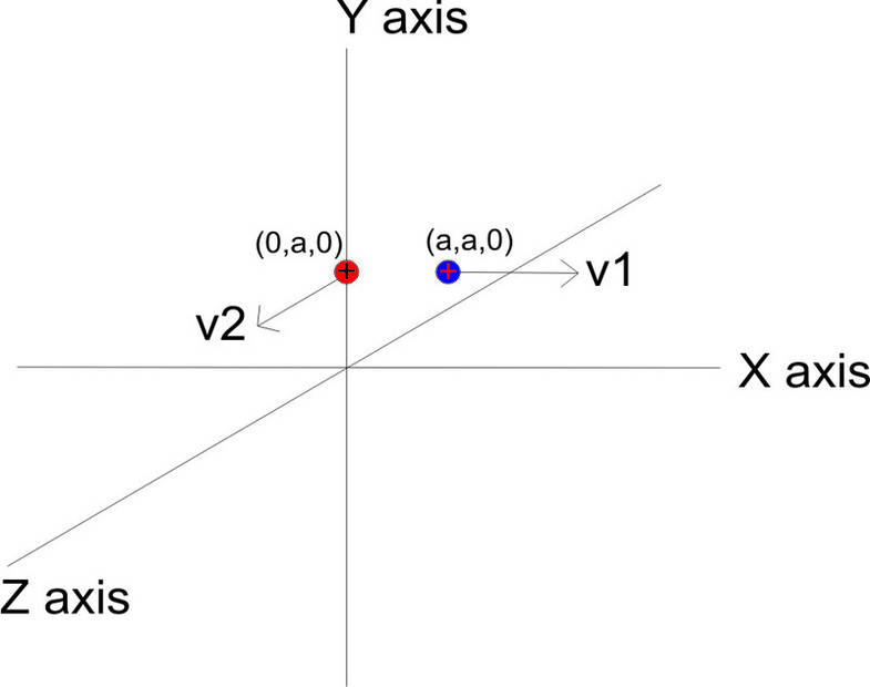

I have only ever seen Newton's 3rd law linked to conservation of momentum (and they are equivalent, at least for "simple" mechanical systems).
Of course you can derive from the 2nd law that for a single mass ##\vec{p}=\text{const}## if ##\vec{F}=0##, but conservation of momentum is usually formulated for total momentum, I can't see how you would incorporate several particles into the 2nd law.
Now, I said Newton's 3rd law and conservation of momentum are equivalent for "simple" mechanical systems. And apparently this is just not true for magnetism in general, as the following simple situation from StackExchange illustrates:
Clearly, only particle 1 feels a magnetic force, particle 2 does not. On StackExchange, this is explained by the magnetic field carrying momentum as well.
And this situation does not look totally dissimilar to my orange structure, where there are charges moving at right angles to each other as well.

greypilgrim said:
Thank you. Now, please help me understand this. Where in the sketch would you draw force vectors compensating the green vector? On what parts of the structure do they act? And by which fields are they produced?Even if there is a "back EMF", Lorentz forces can only act onto moving charges or currents. So where in this system would this back EMF create force, compensating the green arrow?
Did you look up Lenz's Law? See here. (Again, briefly) What happens is that the rail gun uses an electromagnetic field between the paddles to accelerate the charges in the bullet. But the charges in the bullet, in turn, create a new electromagnetic field by being accelerated, which by Lenz's Law (essentially a result of conservation of energy), acts in opposition to the electromagnetic field between the paddles. This, in turn, will act to force the paddles in the opposite direction of the motion of the bullet.

In #17, there was an example of a very simple system (two particles only) where conservation of momentum is violated if one ignores that the field can carry momentum. What makes you so sure that this doesn't happen here, that there's no exchange of momentum with the field?

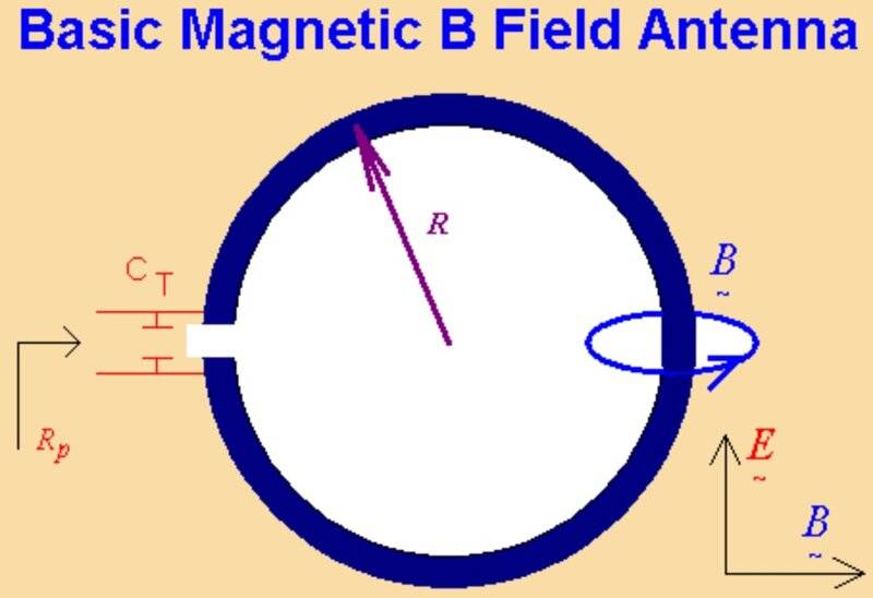

@greypilgrim railgun-inspired antenna:
Magnetic loop antenna (MHz):
(https://www.angelfire.com/planet/sft_accommodation/magnetic_loop_antenna.htm)
Magneto-electric dipole antenna (GHz):
(https://www.researchgate.net/figure/Concept-of-magneto-electric-dipole-MED-antenna_fig5_284019198)
By inserting an open switch into your loop, the plates may be charged to high voltage, thereby establishing a large electric-field ##E## in the gap between the plates (that's the "electric dipole" portion of your antenna). Closing the switch rapidly discharges the plates by establishing a large current in the loop (the "magnetic dipole" portion), along with a concomitant magnetic field ##B## surrounding the loop. The whole configuration amounts to a paralleled capacitor (##C##) and inductor (##L##), oscillating at frequency ##\left(LC\right)^{-\frac{1}{2}}##, and damped by conductor- and radiation-resistance losses. These oscillating ##E## and ##B## near-fields develop into EM radiation in the far-field, and by Poynting's theorem said radiation carries exactly the energy and momentum necessary to compensate for any changes in the energy and momentum of your structure.
renormalize said:
I propose that momentum is conserved in your structure simply because it's essentially an antenna for emitting EM radiation that precisely balances any mechanical momentum imparted to the device.
So you're saying there is EM radiation emitted carrying momentum, but there's still no net momentum change of the device? So the EM radiation is emitted symmetrically such that the total momentum of the EM field is still zero?
Does that mean the Poynting vector in the top half of the picture is upwards and downwards in the bottom half? Because that's the only symmetry I could think of given the structure of the device.
But again, what makes you think that momentum of the device itself is conserved, while it is not in Feynman's example if just the particles are considered?
Not at all. What I said was that the radiation compensates for any change in the momentum of the antenna. Most all antennas, including yours presumably, are non-isotropic and emit more radiation in some directions than others. So think of an antenna as a "photon rocket". If the radiation-pattern is unbalanced (like from a parabolic dish antenna) and the antenna-directivity points east, there will be a reaction force on the antenna pushing it west. But if the radiation pattern is balanced in every direction, like from a dipole antenna, there is no net force tending to push the antenna left or right, up or down, fore or aft:
Okay, then I misunderstood.
But then you're saying there IS a net force on the device, leading to an acceleration (contrary to what everyone else in this thread was trying to convince me about)? Is it in the direction of the green arrow?
I haven't said that either. You'd have to calculate the radiation-patterns and predict the radiated-power of the device over the entire frequency spectrum of current flow expected as the capacitor discharges and the current begins to oscillate and decay. At first glance that appears to be quite a formidable task. But you could check the literature for the similar MED antennas to get an idea of radiation patterns at the frequencies where they operate to see how directive they are.
But as a guess, more radiation may be emitted backward in the direction of the capacitor (since that portion is a break in the magnetic-dipole loop), than in the in the forward-direction of the green arrow. If that's true, your antenna would accelerate forward like a "photon rocket" until the energy originally stored in the charged capacitor (the "fuel") is expended and the radiation ceases, after which it would coast at constant speed. In other words, everything would happen in accord with Newton's laws.

For the moment I'm focusing on the forces acting at very first moment when the left plate is positive and current starts to flow clockwise.
I'm sure it's in accord with conservation of momentum, but is there really a Newtonian 3rd law formulation (i.e. with forces) when it comes to photons? Anyway, that's just semantics.
Some energy will also dissipated as heat due to the resistance of the wire. Can there be made a a very, VERY rough estimate about the percentages of energy radiated and dissipated as heat in the limit ##t\rightarrow\infty##? Or are there calculations/measurements for real antennae?

Also one should note that, when taking into account field momentum to get the conservation laws right, you need to calculate everything relativistically. This gives rise to the somewhat unfortunate notion of "hidden momentum", though it's just momentum done relativistically right. There are nice examples in Griffiths's E&M textbooks and (imho even better) on McDonald's website:
http://kirkmcd.princeton.edu/examples/
The most simple "magnetostatic" example is
http://kirkmcd.princeton.edu/examples/penfield.pdf
Likes hutchphd
