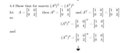

this is a c/p from my overleaf DE hw
but on proving this I only used a $2\times 2$ matrix
Also I thot $A^2$ meant A(A) a composite but the calculators just multiplied it.typos maybe:rolleyes:
If you think of a matrix as an operator, then matrix multiplication is functionally equivalent to composition. Recall that $(AB)^T=B^T A^T,$ so that
$$\left(A^T\right)^2=A^TA^T=(AA)^T=\left(A^2\right)^T.$$
