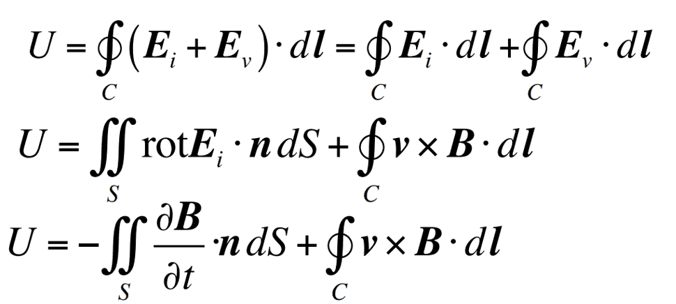

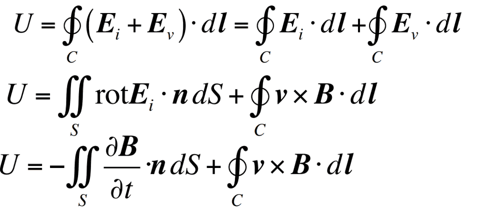

$$rot \vec{E}=-\frac{\partial{\vec{B}}}{\partial{t}}$$
$$\vec{E}=\vec{v} \times \vec{B}$$
I think Voltmeter's needle will not jump in both situations. But the answer is yes.
I am going to use this to explain why.
The reasons to create the voltage are by
- The changing by time of Magnetic field
- The move of the object in magnetic field
In both situations, they are not occur so I think the voltage's needle doesn't jump
