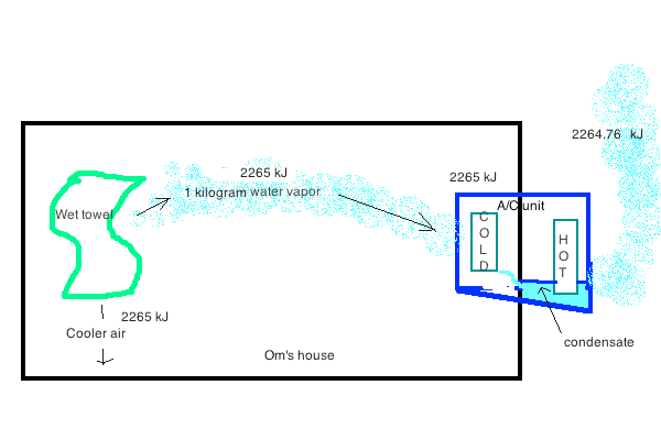

After thinking about this, I think that wet towels may actually improve the efficiency of the A/C unit.
Say you have wet towels that hold 1 kg of water.
As the water evaporates, the the towels will cool off, cooling off the environment. 2,265 kilo-joules of free swamp cooling!
But, the extra moisture will cause the A/C unit to have to expend that much energy to re-condense the moisture: Zero sum (theoretically...)

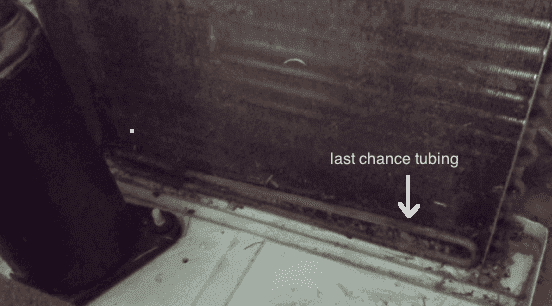

But one thing I noticed about my brand new window A/C unit, is that the condensate is routed to the outside section, and the hot radiator actually sits in the pool of cool condensate.*
So as that water evaporates outside, it will act as a kind of swamp cooler, and carry that energy away, making the unit consume less energy.
*I actually thought they had forgotten to put a drain hole in my old A/C unit, and was going to drill a hole in the bottom. Fortunately, it died of heat stroke last year before I got around to it, as when I saw my new unit didn't have one either, I decided that they must be designed that way. Then I scratched my head for a few moments, wondering why, and then said to myself; "Ah ha! Brilliant!"

russ_watters said:
Does the coil just sit in the water or is the water dripped or sprayed onto the coil?
Most of the window units I have seen splash water on the condenser using a ring built into the fan.
BoB

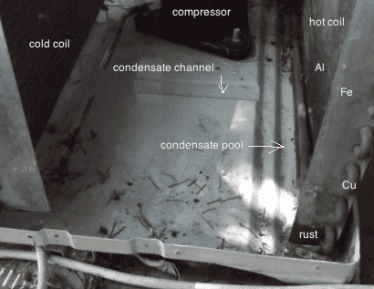

Both the old(2004) and new(2015) unit have the hot coil sitting in the drip pan.
My old A/C unit​
The rust band is about 1/2 in tall.
I think such a feature is required in Europe and Japan, but I haven't seen it much in the US.
I have run tap water to sprayers on the condenser of my split system AC unit, which gives up to about a 20% efficiency boost (half output increase, half input reduction), but it is only economical when it is hot out due to the water cost. Using the condensate is of course free and I may try to do that.
Free is a good price.
Another thing I noticed, is that there is a u-tube of copper tubing, coming out of the condenser coil, that sits in the pool.
My old A/C unit.
I'm not willing to take apart my new A/C unit, to see if it has this tube, as it's supposed to be 88°F today.

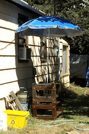

But I am really curious about all this, so I constructed a temporary shade for my A/C unit a few minutes ago.
One less variable is always a good thing.
ps. Fun thread. :smile: I've pretty much figured out what most of the components in my old A/C unit do. There are a few things not shown in the diagrams I've seen. ("What the heck is this little micro tubing?")
pps. And given that it was only 60*F this morning, and couldn't get my old A/C unit to turn on, I burned myself after heating the temperature sensing probe, and touching it to see if that was the problem. Ouch.
And then I electrocuted myself trying to rewire the thing, to bypass the temperature sensor.
Apparently, I hadn't had enough coffee. :redface:

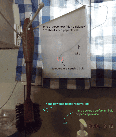

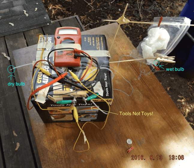

Synopsis of the 11 hour experiment I did yesterday:
Humidity dropped from 76% to 67% inside the house, within the first hour, and then did not change.
I am confident that the humidity actually dropped, as the condensate pool went from dry to full in less than an hour.
I am not confident in the actual numbers, as I made my own psychrometer.
I was hoping the condensate tray would remain empty long enough, such that I could make a comparison of temperatures between empty vs full tray, but it filled up really fast.

A homemade psychrometer can be a hair attached to a dial or marker.
I never made one, but now curiosity may make me do what I should have done years ago when I had adequate hardware. Ha Ha
256bits said:
Interesting stuff.
It appears that I made the modern equivalent of the 1861 model.
I folded a paper towel in half over my hand dish washer tool drip dryer, wetted it, and stuck a very light RTD probe between the sheets.
As long as the surface tension was able to hold the two halves together such that the RTD didn't fall out, I figured it was working.
ps. After some more observations, I'm having severe reservations regarding the "conventional wisdom" of the primary purpose of the "slinger ring". Although I'm in firm belief that the condensate pool increases the efficiency of a window A/C unit, I think the slinger blade serves more to try and clean up the pool.
Hygrometer, or the preferred name in the 1700's the wiki says by some, the hygroscope.
But then I see you went all high tech with a modification of the wet bulb-dry bulb technique.
  • #31
I love the hand powered surfactant fluid dispenser and the debris removal tool BUt...' the temperature sensing bulb'...too 20Century
  • #32
High tech, and low brow. o0)
I build a portable version yesterday morning, and took several measurements.
They made no sense.
So I redesigned it.
Code:
location      % RH      mg h2o/kg air      temp (°F)       notes
model 1
kitchen        61       10.70               74             furthest point from A/C unit. should have the highest moisture content
LR south       58        9.80               72             where I sit and stare at data. should have a median moisture content
MBR south      70       10.10               67             where the A/C unit is located. should have the lowest moisture content
conclusion: there was something wrong with the folded paper towel design
theory: the huge plane of moisture was creating a localized increase in humidity
model 2
kitchen        63       11.70               75
MBR south      60        9.00               69
Back Porch     44       13.70               91
kitchen        60       11.50               76
MBR south      62        9.30               69
conclusion: "relative humidity" is an annoying concept. look at the "Back Porch" numbers: lowest relative humidity, yet the highest moisture content by mass.
