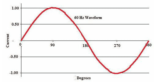

Say there is 100A on this cable, then following the sinusoidal waveform of the current it will go from 0A>100A>0A>-100A>0 over one cycle as shown below:
(Credit for the picture to: https://www.researchgate.net/figure/Alternating-Current-Waveform_fig1_317165946)
This creates a pulsing magnetic field; for a 50Hz circuit then that's 100 pulses a second (1 for each peak).
On the above chart you can remove the word 'Current' on the 'y' axis and replace it with 'Tesla', showing the magnetic flux density increasing as the current increases.
It's this constant increase and decrease of the Magnetic flux density, that simulates movement.
To induce a voltage you need to move the cable through the magnetic field, but as the magnetic field is pulsing (going from a high Tesla down to a low Tesla and back again) this simulates the movement and thus induces the voltage on a stationary cable.Thank you for answering my question though; so magnetic fields do not interact with each other? So this pulsing magnetic field will not interact with the flux in another magnetic field?

The sum of the fields would be sqrt(a^2+b^2). But my question refers to the interaction of a pulsing magnetic field with a nearby static magnetic field.
It is linear. I already said that.
