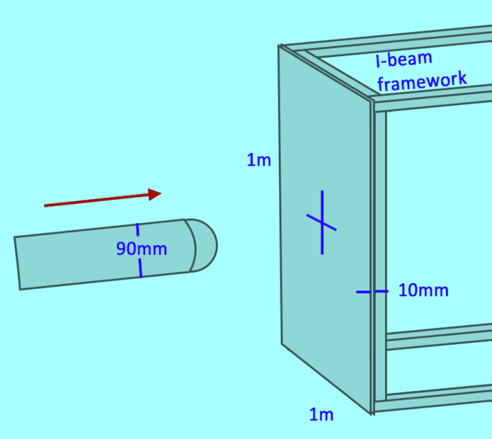

Assume a 1 m x 1 m plate, about 10 mm thick, surrounded by water on all sides. No pressure vessels are involved in the collision. The plate is an idealized target, one can think of it being welded on all sides to a more rigid structure made of I-beams.

Not a sharp point. The impactor will be 90 mm dia cylinder with a rounded (say, hemispherical) impacting surface, approaching perpendicular to the plate at its geometrical center. At the instant of the impact, the kinetic energy is 5000 J per previous reply.
This would be narrows the situation down to a very specific case where the ROV (remotely operated vehicle) docking probe of standard geometry is impacting the structure.

OK, maybe this clarifying diagram is coming a bit late and a bit redundant. Things were changing pretty fast there for a bit...
Anything else I can add?
I thought that, not just the corners, but all the edges of the plate were kept co-planar, supported by RSJs = I-beams, arranged parallel to the edges.
Ok, yeah. Updated.

This is spot on. Much better than I could have drawn.
