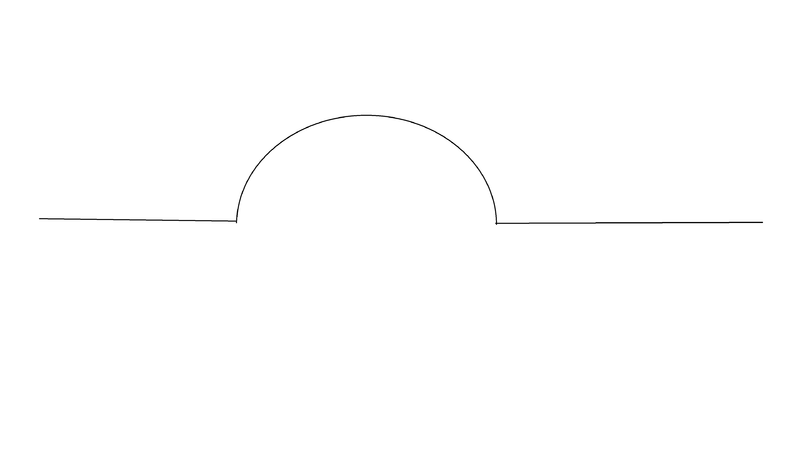

Accelerating electric charge produce EM wave
Does constant DC current in curved wire produce EM wave, because el.charge has radial acceleration in curved wire?
hutchphd said:
So in case of curved wire, centripetal acceleration can cause EM waves but very weak?
No, there is no radiation. For ##N## uniformly-spaced charges flowing in a DC circuit, the radiation from each of the individual accelerating charges destructively interferes with that from the others and the total emitted radiation vanishes as ##N\rightarrow\infty##. See Why Doesn’t a Steady Current Loop Radiate? and A Steady Loop Current Does Not Radiate.

What if wire is not closed loop, just half of circle?
It's still ultimately a loop, since for current to flow a circuit has to close back on itself somewhere. In the real world, you can't place your source (battery) at infinity.
