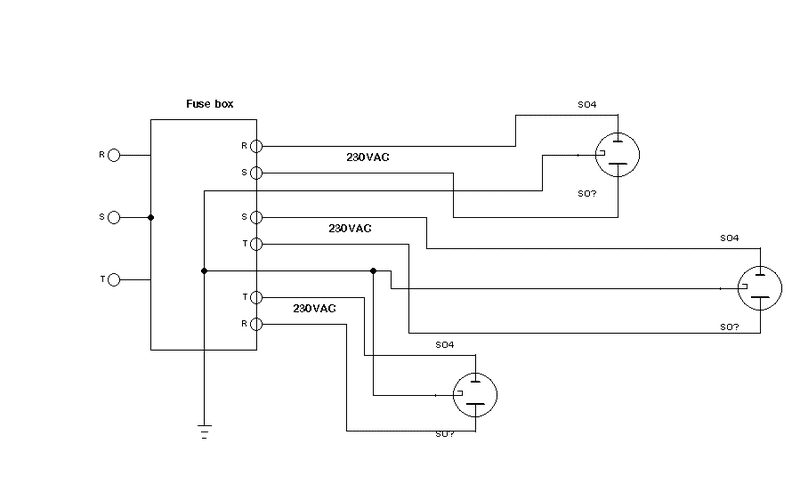

In Europe (at least in Norway), the classic Power distribution system is three-phase AC, no "Earth". "Protection Earth" is the responsibility of the Builder. Inside the house, all outlets are connected to two of the phases, there is no "Neutral". The potential between any phase and "Protection Earth" can be more or less anything. "Protection Earth" is supposed to stay more or less in the "center" of the three phases, but in practice it can be far off.
I have to repeat my point that Neutral, for a normal domestic appliance, is the only other conductor to carry current but neutral in a multiphase system will not; it is far more complicated. There may or not be a neutral conductor involved. But all that is irrelevant to the OP and to most of the questions that appear on PF.
