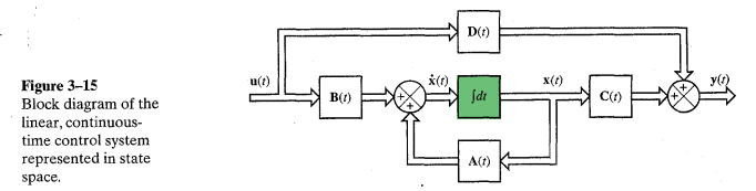

Hi,
Let's call the box in green a plant. Does every plant consist of an integrator? It has to because when [itex]\overset{\cdot }{x}(t)[/itex] passes through the green box, it becomes x(t). It's an operation of integrator; integrator converts the derivative back to the variable. Could you please guide me?
You designate an integrator 'the plant' and then you are surprised that a 'plant' integrates?
Likes PainterGuy
No, not every control system has an integrator. But yours does.
However, most control systems contain an integrator. That's how you make it achieve zero DC error.
Likes PainterGuy and AlexCaledin

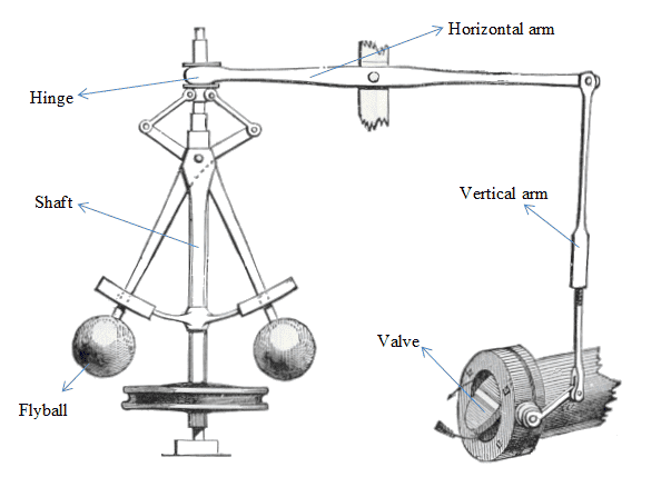

But many control systems have negative feedback and proportional output. No integrator. For example, James Watts' flyball governor.
Likes PainterGuy
PainterGuy said:
Hi,
Sorry, I miss read your question. No, not every plant acts as an integrator, in fact that's common in my experience. Most plants are proportional. The integrator is normally applied as part of the control system.
However, this partly depends on how you define the inputs and outputs. So, for example, a motor may have speed proportional to applied voltage, but position is the integral of applied voltage. So, same motor, but different behavior depending on what you want to control.
Likes PainterGuy, eq1 and Merlin3189

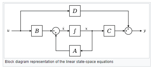

I don't think my question was phrased properly. Let me try again.
It's not me who designated an integrator as the plant rather this is how the state representation is shown. Please see the figure below. The representation suggests that an integrator is always there present and when [itex]\overset{\cdot }{x}(t)[/itex] passes through it, it becomes x. In other words, an integrator is a natural part of state space representation. Where am I going wrong?
https://en.wikipedia.org/wiki/State-space_representation#Linear_systems

I suspect your question is bordering on semantics. A system with no integrators (or derivatives) can be described in the state space format, such as:
$$ \begin{align}
&\dot x = Ax + bu \
&y = Cx + du
\end{align} $$
But without integrators (or derivatives), there is no state of the system. It's not dynamical and has no memory. So, A=0, b=0, C=0. It is the zero order trivial case that reduces to a set of linear equations. So in practice, no one talks about state space unless there is a state, i.e. unless there is at least one derivative.
Also, of course, the canonical form shown differentiates the equations to eliminate integrals in favor of derivatives.
I think there may be some confusion in the responses between what is the plant, what is the compensation, and what is the system. My take on your block diagram is that it is the canonical form of a generic linear dynamic system in state space form. It really doesn't matter at the system level which is the plant and which is the compensation when you are solving a previously designed system. Of course it makes a tremendous difference when you are designing that system.
Likes PainterGuy, eq1 and BvU
Also that Wiki page talks about the representation of a linear system. Not all systems are control systems.
Likes tech99 and PainterGuy
